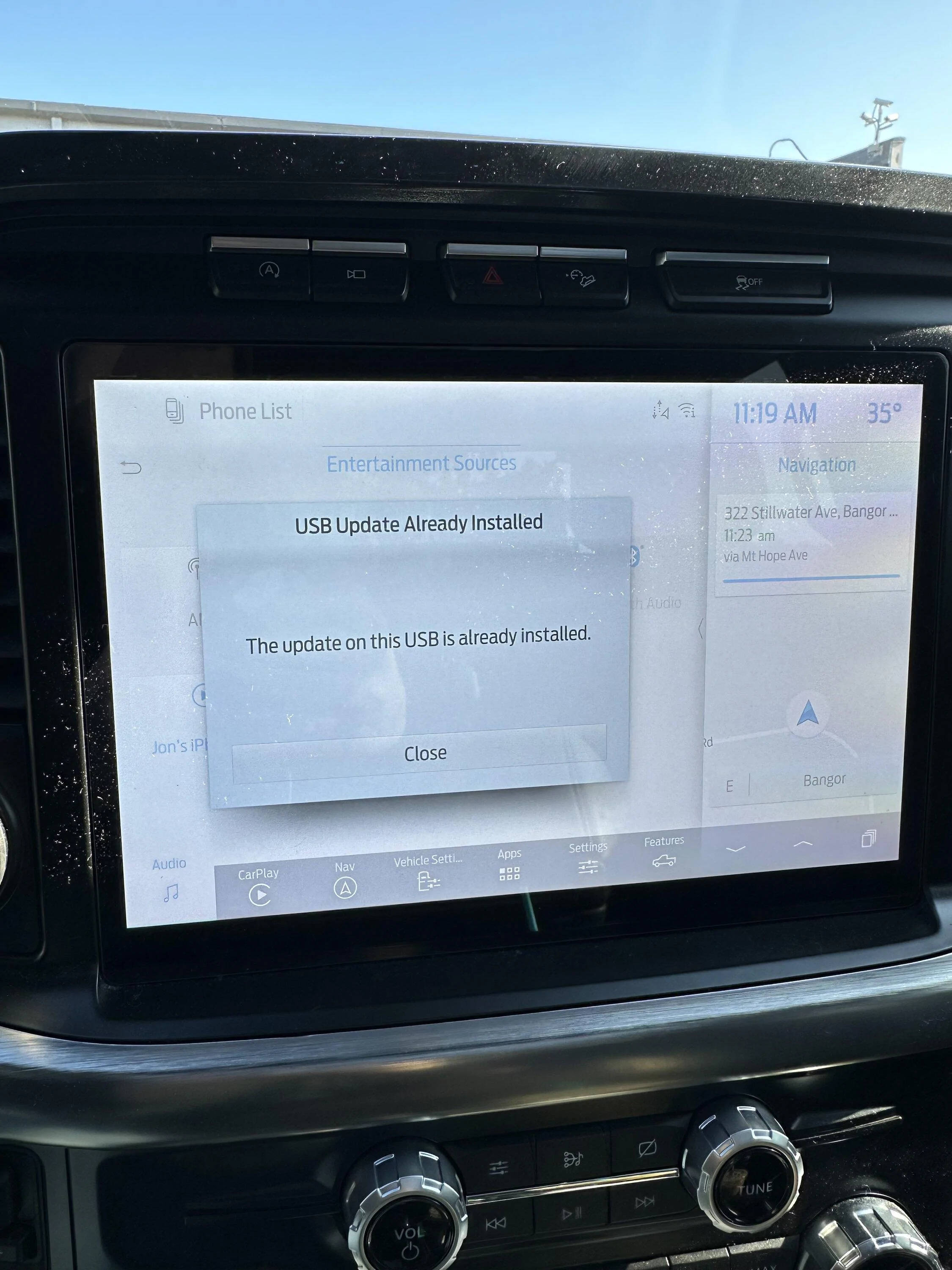

Yeah that should be the MU5T-14G682-JU. Assuming thats one of the files you loaded?
rugedraw
Javier
Dec 14, 2021
7,413
9,008
Miami
Auto Sales
I don't think he knows how to answer that. First time using FDRS. He was on Sync 22146, so it must have gone through.
@PizzamanJon Time to go back to work with the updates. Maybe driving the truck charged up the battery enough. As was mentioned before, when it gets cold, that battery is going to struggle, so get it now or get it later.
