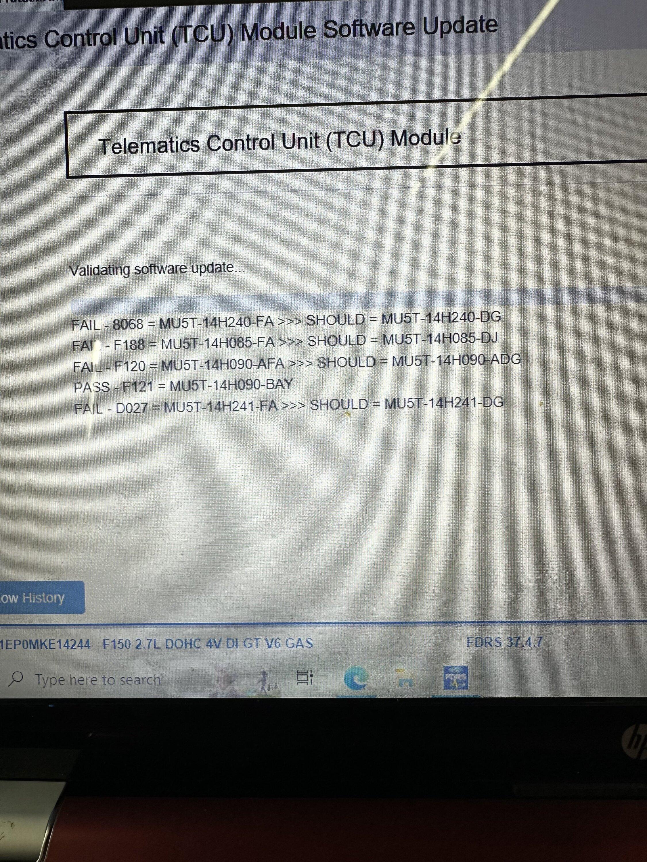

Validation failed. Reprogramming in progress. I formatted the USB again and it’s redownloading the data to the USB.

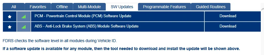

Let it do it's thing. I don't want to log into FDRS with your VIN while you're in there jic it causes an issue. When you're done, post the list of updates you have pending.

Same message “ the update on this USB is already installed”

Yeah. Its looking for the files that are in the TCU update that is pending. I would try and run the TCU update that is available in the List. @PizzamanJon
Nevermind. Its apparently not downloading those files to your usb. @PizzamanJon Can you look at the USB and see what files are in the folder?
