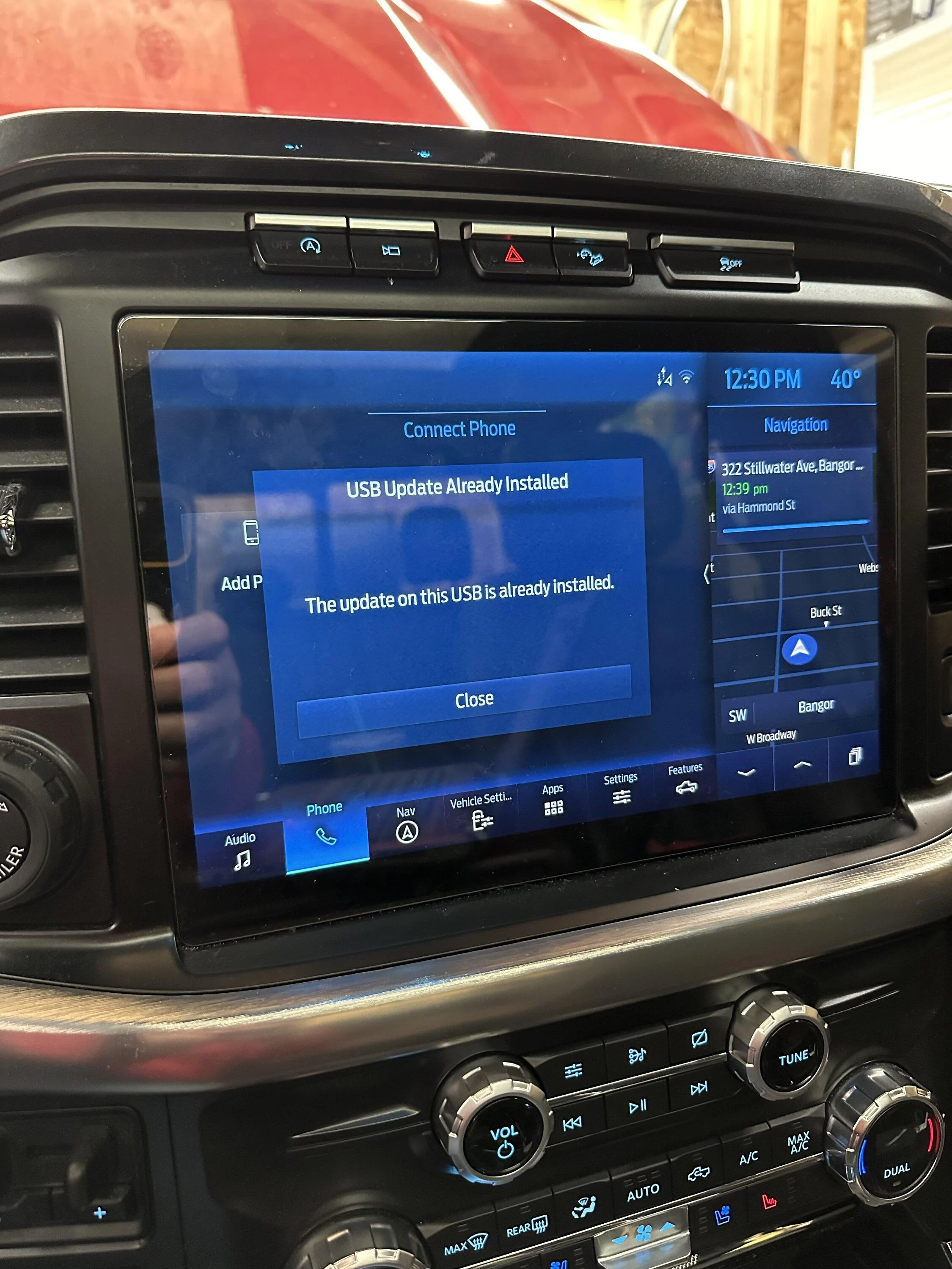

Updating TCU and FDRS downloaded data to usb. Put in truck and it says the update is already installed. Should I tell fdrs it updated correctly?
Ford F-150 ECU module programming guide using FDRS IMG_3148
Did you format the USB to exfat again before putting the TCU updates on it? If it still had the files from the APIM update on it, then hit no.
Yes I did, after APIM was verified and the truck started the TCU and then instructed me to insert usb into computer. So I plugged the usb in, formatted it verified it was empty then continued in fdrs. When I started the APIM it said it was a multi module update. Could it have done it already?

Yes I did, after spin was verified and the truck started the TCU and then instructed me to insert usb into computer. So I plugged the usb in, formatted it verified it was empty then continued in fdrs. When I started the APIM it said it was a multi module update. Could it have done it already?
Yes! That is the equivalent to OTA 2.6.0 that updated both the APIM and TCU. I think you're good to go.
