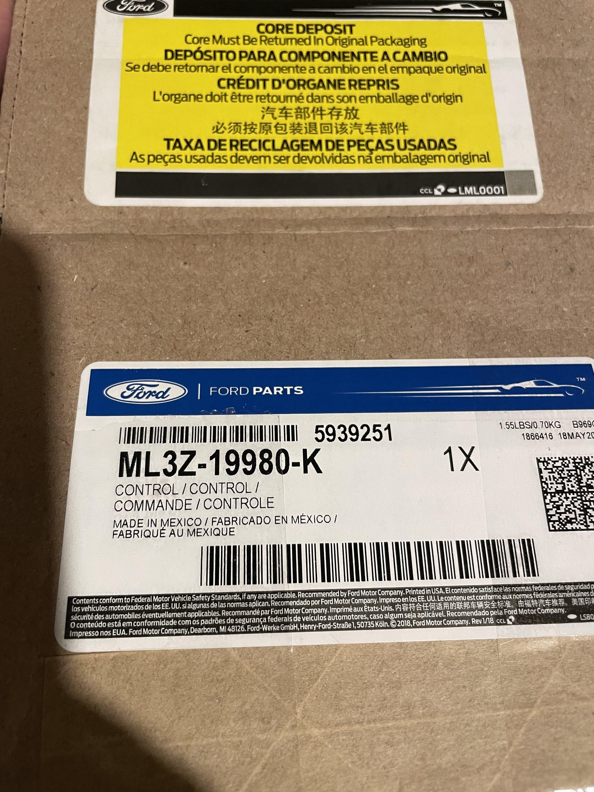

Purchased about ten days ago from Tasca for my heated steering wheel
Project when my 22 finally arrives. Was ordering for the heated wheel and was shocked to get it with the led readouts.
I came to this thread looking for this exact post because I bought one for the same price at this time. I was going to share it with another member who may buy one from another member, and I was thinking, you are overpaying.
Well they aren't. This thing has tripled in price.
I'm so happy I got one when I did.

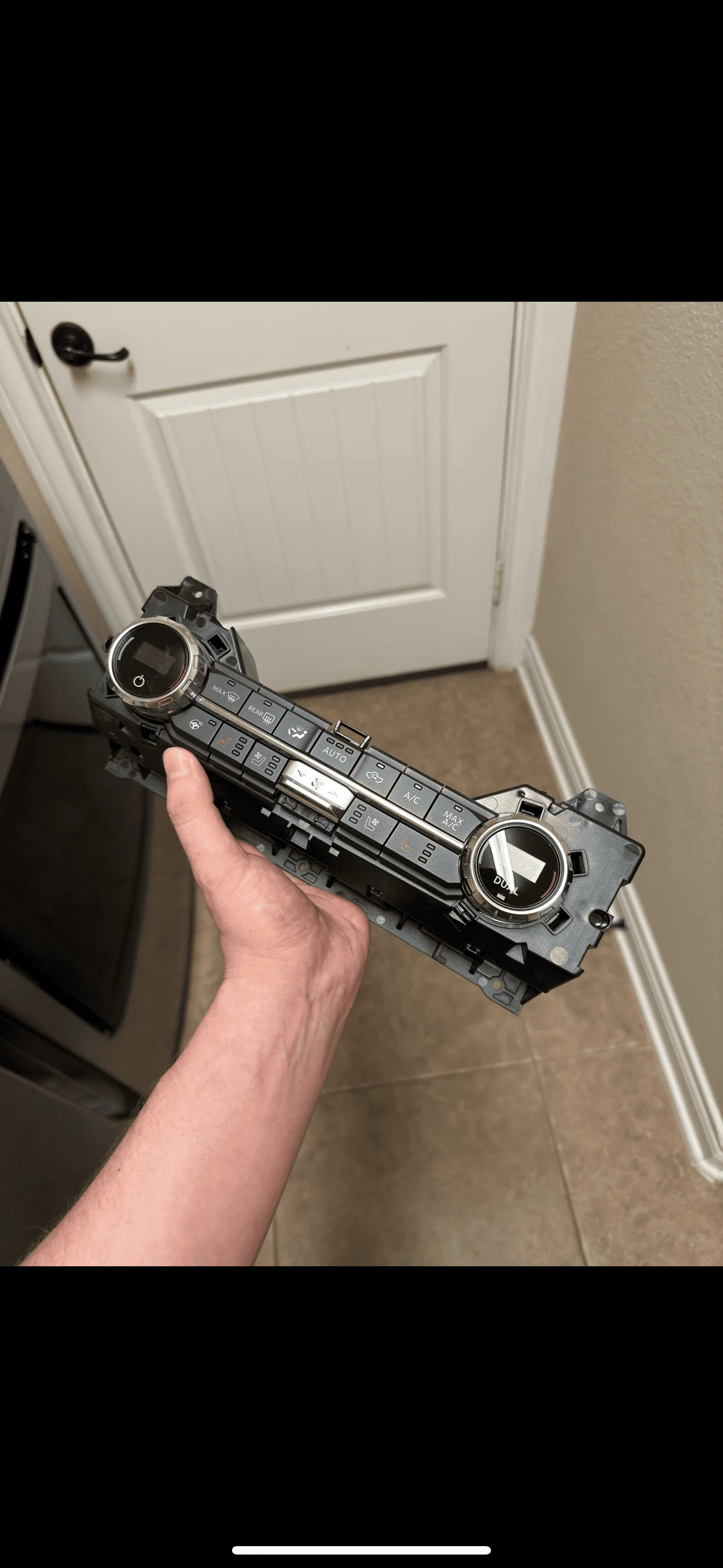

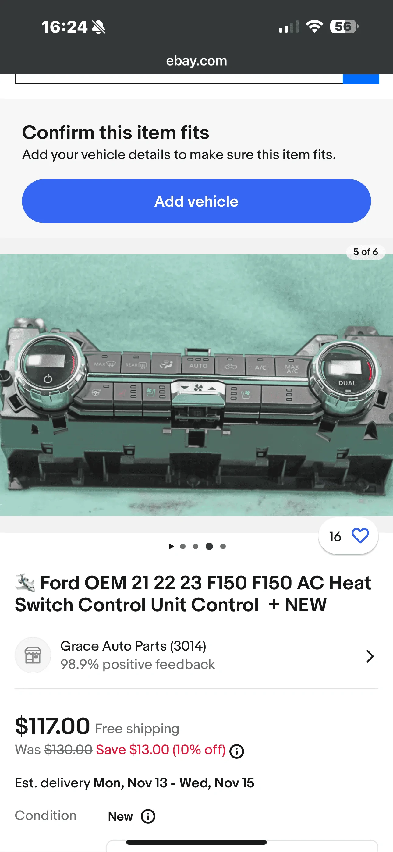

Well I just ordered this hopefully it works out

Good price. Hope it works out.

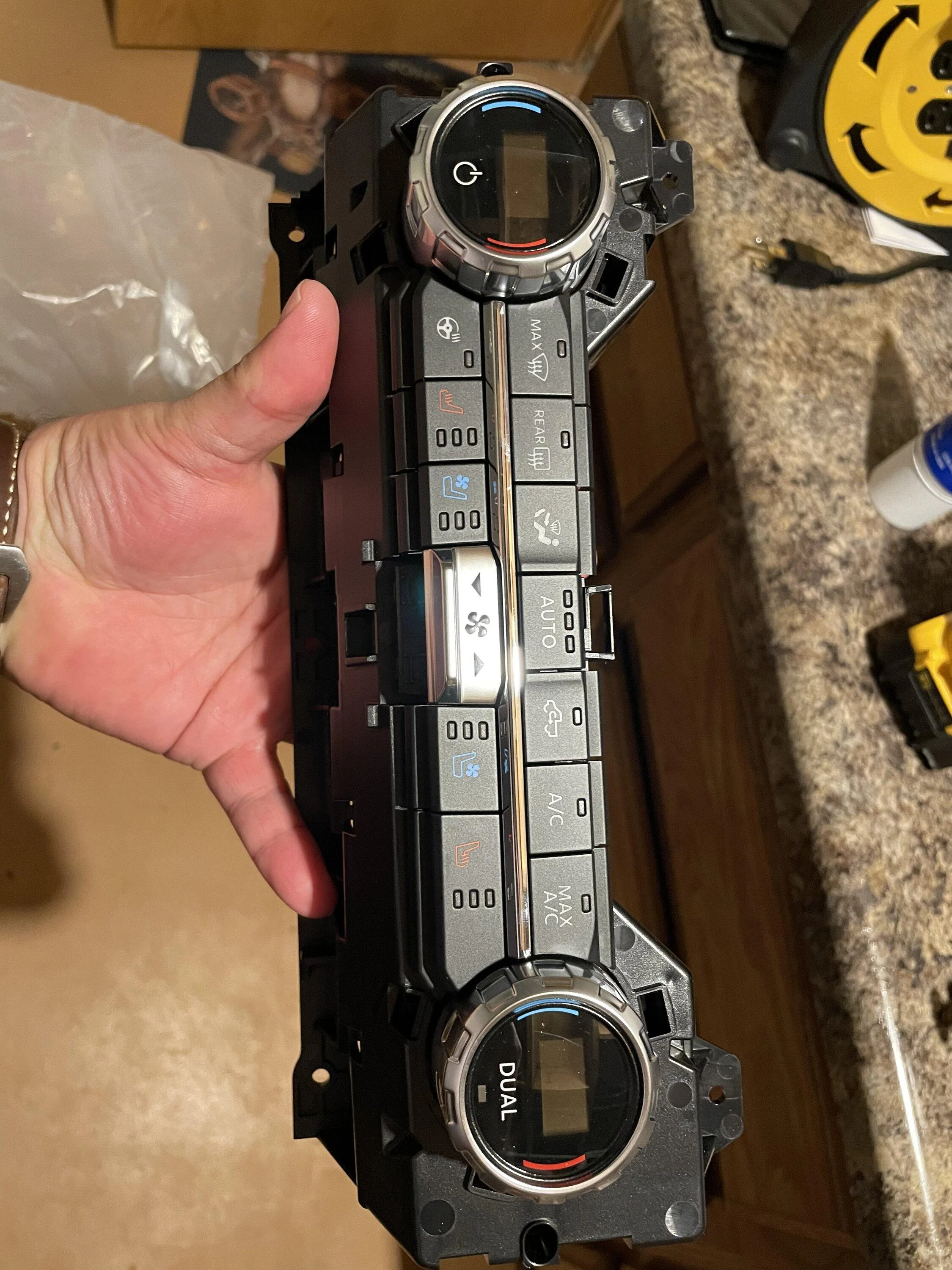

Came in today, said it was new but there’s dust all over it, unless it was sitting in a warehouse unprotected. Didn’t come in a bag but was also 120 bucks so I probably can’t complain. Will swap it out when I get the rest of the interior lights in.

I bought this same unit from the same seller on ebay. I was able to install it without any issues and it works great. I will say that prying the plastic trim pieces off of my 1 month old truck was terrifying, especially when it's 25F outside and those trim pieces don't come off easy at all.
It seems like a small change, but it really does improve the look and function of the HVAC controls. It's kind of frustrating that Ford continues to leave this out of new builds, It can't cost them that much more. I feel much the same way about the rear fender liners (which I installed as well). Come on Ford, don't nickel and dime me on a $70k+ vehicle.

How'd the install go?
