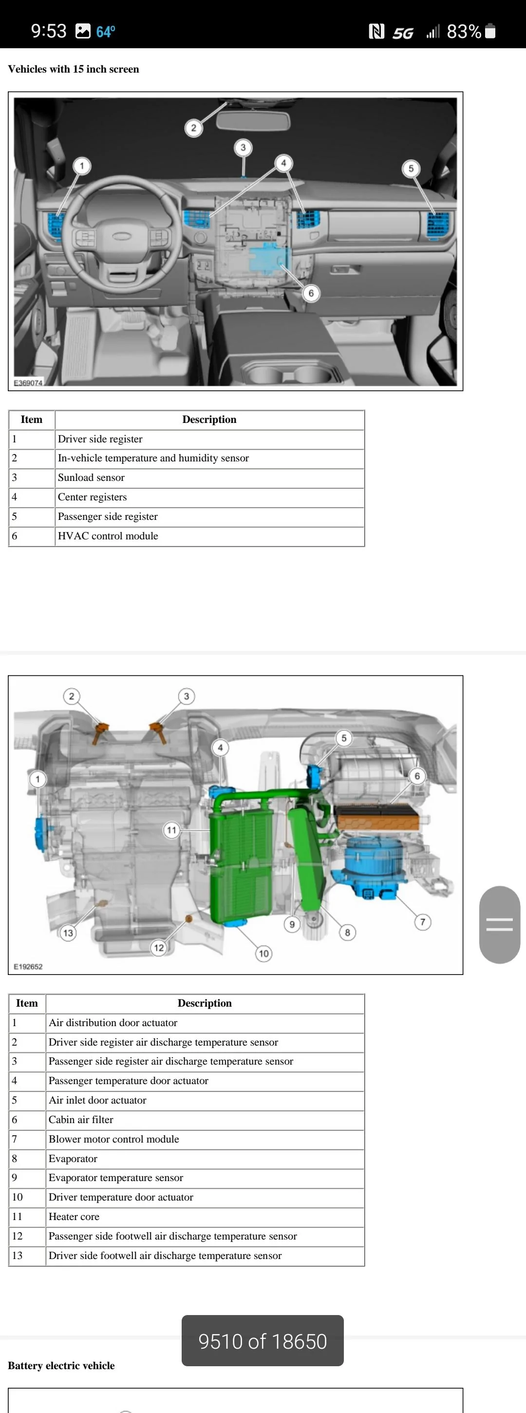

I fiddle more with this “automatic” temperature control than any I’ve owned.
Lots of temperature sensors. They're everywhere. Therefore lots of software too.
Perhaps too much complexity and potential for failure points?
Ford F-150 HVAC Auto Climate Control too Hot Screenshot_20231104_095317_OneDriv
Samson16
Mar 24, 2023
3,622
3,587
Orlando, FL.
Aviation systems
Sensor #2 is the inside temp/humidity sensor. It would help to know what it reads, but regardless it has a clunky automatic system. The compressor is fantastic and it also heats up quickly, so the important stuff is nails. With the Outback and the CL55 before that I just set my desired temp, turn the outlet vents upward so they don't blow directly on anyone, and just like at home the system takes care of the rest. If they overdid it that's sad because it more closely resembles my '06 H3 lol.
This sorta indicates my ongoing hypothesis on the temp and humidity sensor possibly being part of the problem.
Unit sends super hot air out of the floor vents. Feet sweat. Body is plenty warm. But up by the temp sensor it still reads that the cabin is too cold. Keeps pumping heat until it reaches setpoint up by the ceiling.
