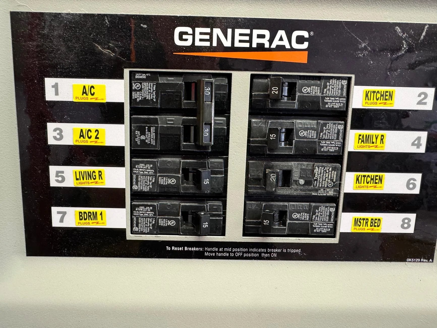

Amen. I had a certified electrician install a code compliant Generac transfer switch. It works. Enough said.
Spend it once and it is good for a lifetime…….and now that i have a secondary generator, the Generac works with that too. So it will outlast my Ford!
