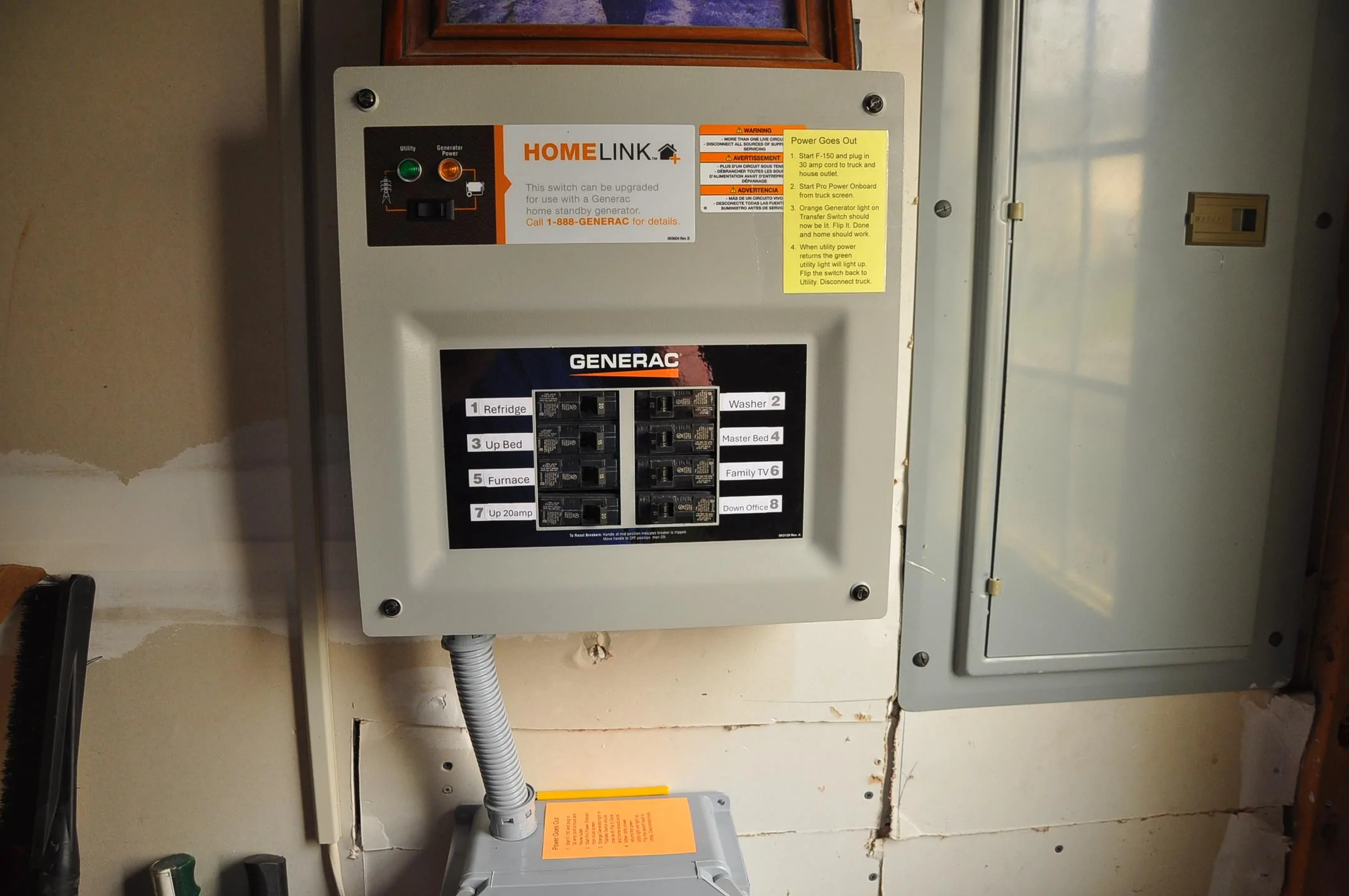

That little Generac 6852 is a wonderful thing.
Ford F-150 Installed Transfer Switch in House GeneracInstalled

Pretty clean. I didn't realize their little ATS was simply a 2/3 pole reversing contactor.
The subpanel on the right -- what circuits are in it? I would have moved most of the 120v room/lighting circuits to it and backed up the entire panel with the ATS. Most rooms use ~200 watts or so at most, particularly with LED lighting. The little so called "critical loads" ATS panel leaves too much utility on the table for me personally. This opinion is based on a location with ~4 yearly power cuts that range from 3-24hrs, most about 4hr or less depending on how bad of a storm system comes through.
