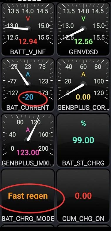

...... And this is coasting and falling below 15 mph with 0% TPS, and stopped at stop sign. Draws current FROM battery! Stupid algorithm. This occurs at 70, 80%, any SOC. most often additional loads will keep this from going negative. Notice "Fast Regen". Avoid this mode with headlights and or fan blower. Keeps in Slow Regen. Once vehicle first starts at beginning of commute, charge mode usually is in "Conventional mode" initially.
"Generator Voltage Desired" (GENVDSD) is commanded Lower than battery voltage, causing the battery to supply the vehicle at traffic lights, sometimes idling, until battery gets pulled down to the lower alternator voltage (Less delta between battery V and Alt V). Sometimes is briefly 30-40 amp draw.

....... This new battery works better than the original ever did. I just hope Ford's stupid charging algorithm doesn't damage it over time. You can't see the "Cumulative Discharge" parameter because you have to scroll the phone, but these are in Killowatts, and takes a commute or so to increase even 100 watts (0.1). When resetting the BMS this weekend, 30 kW charge, and 24 kW Discharge had accumulated (I reset it about 14 months ago). So even with a less than optimal charging algorithm, more went into the battery than came out. I believe it shouldn't be that close to breaking even, which leads to not holding up to parasitic loads for as many days as it could. In my opinion, the only discharge should be the necessary parasitic loads, initial dome lights, etc., and starter cranking. Not hefty loads at every stop light! At least put a huge diode inline (check valve) to prevent back flowing, or program the damn alternator to NEVER fall below the battery's voltage. Time will tell. I've got a plan anyway to circumvent these charging shortcomings. But before that, I will turn OTA updates back on after this past year of being disabled. I hear they've addressed some charging issues.

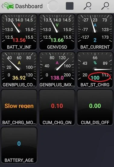

New battery accepted an additional 3% and should have read 103%, but that forscan variable cuts off at 100%. At the idling at 2 amps for just over an hour flowed an additional 3% that the battery accepted. I still have the module thinking I have a 70 Ah H6 battery, which is 1% for every 0.7 Ah. I just gave it an additional 3%, but as you see, displays 100% max. The battery should hold 12 Ah over the 100%. At least the larger battery is still accepting charge. Will go in and change battery size to H7 soon.

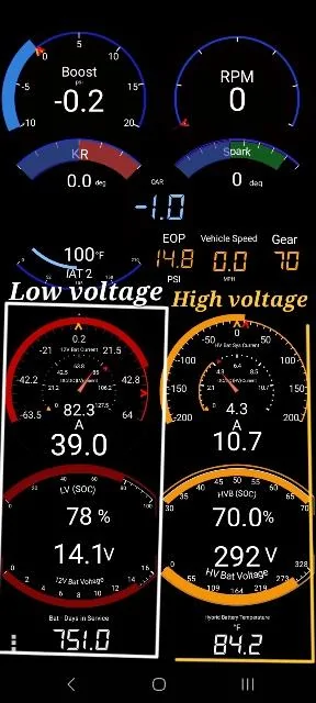

At startup:
Low voltage values are the 4 PIDs in the white box.
1. Alternator (DC/DC converter supplied current-amps)
2. AMPs +- (+ is amps into the 12V AGM
3. Ford's SOC value for the battery
4. Voltage (Alternator-DC/DC converter)
Also display the # days battery in service
Ford F-150 Factory battery ongoing issues 20240429_183105
Comment:
In 2 years of monitoring, I have never seen the alternator supply 40 amps to the AGM. Certainly not at a SOC of 78%.
In fact, the "target" always felt like ~80% SOC was a happy place and as it approached 80%, the amps supplied would be barely more than a trickle charger. And the voltage would drop into the high 12x/low 13x
14.1 @ 40 amps was unheard of!

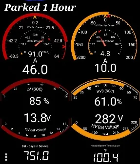

At 16 miles I stopped to grab a couple of grandkids. A little more than an hour parked.
As mentioned, this is a tired AGM.
It dropped 5% SOC over that hour.
When I start the truck back up and head for the house with precious cargo on board, the truck obviously thinks 85% SOC is below the target. ?
46 AMPs at 13.8V
That's simply stunning compared to the original conservative strategy.

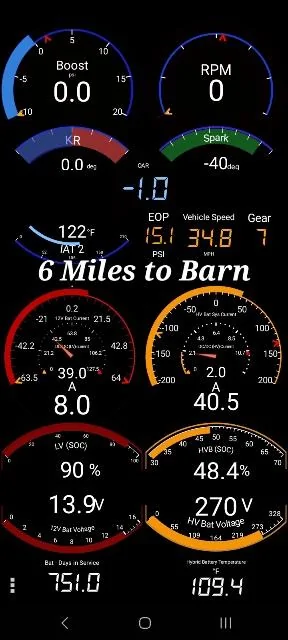

6 Miles later parked in the barn
Ford F-150 Factory battery ongoing issues 20240429_184349
90% SOC and still beyond trickle charging rate.
