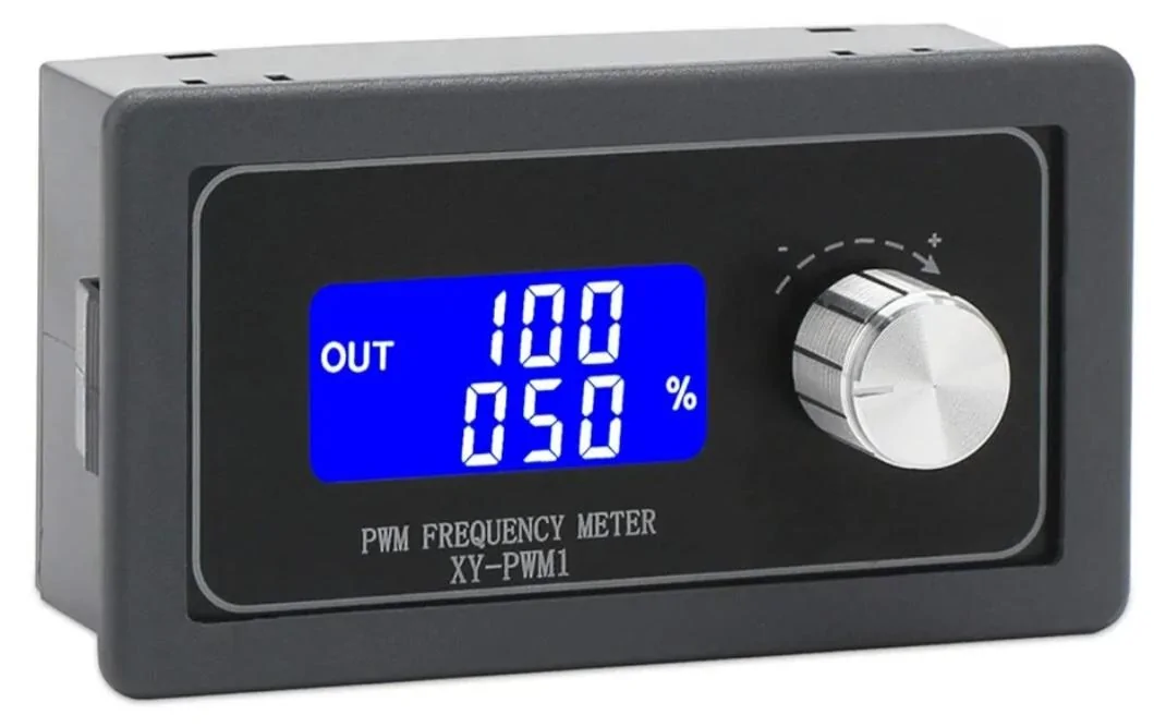

Maybe someone can help "me" find something. Which module, connector & wire color does the "Gencom" signal use, going to the alternator? I think it should be the center wire of the alternator's 3-wire connector, possibly an "RC" signal on the alternator?
I plan to conveniently switch the alternator side of this soon to be "cut wire", between it's original connection (factory PWM source), and a PWM module (pic below) that I manually adjust the duty Cycle of the selected 100hz signal. This will allow me to dial up any steady alternator output voltage, driving and accelerating any charge current within reasonable limits. This will prove useful for cold weather and short trips. The BMS will still tally up the ramped-up Amp-hours, show charge-current, etc., but also allow me to not worry about adding enough loads to keep charge-mode from going into "Fast Regen". It will also allow me to charge with a few more amps, speeding up the process. Not that I'm trying to charge fast, but how rediculous is driving for hours at 1 amp or less, when clearly there are way more Amp-hours to replace! $12
And a 3-position (center off) toggle switch, placed in center position should simulate unplugging the alternators 3-wire connector, placing it in "dumb mode" with a steady 13.8V, regardless of rpm, the way alternators used to work.

Unfortunately you don't get off that easy. Communication is done via LIN bus. No PWM/Voltage sense modification for you. Given the latest rounds of software updates, the forscan set point seems to be alive based on reports. IF the new BMS logic was OTA'd to you AND you have forscan, change your SOC set point to 95% or so.

Thought for sure this was a PWM alternator. Tried to get to the 3-pin connector the other day but it's underneath it. Could only see a single small gauge conductor entering alternator from the side. Could this be the comm wire? I was going to get underneath and remove air dam so could get to the 3-wire connector. So you're saying it doesn't even have one?
Not per the manual. When it says LIN it's LIN. There's likely diagnostics data on there as well, not just voltage command. Even the battery shunt communicates on LIN bus.
