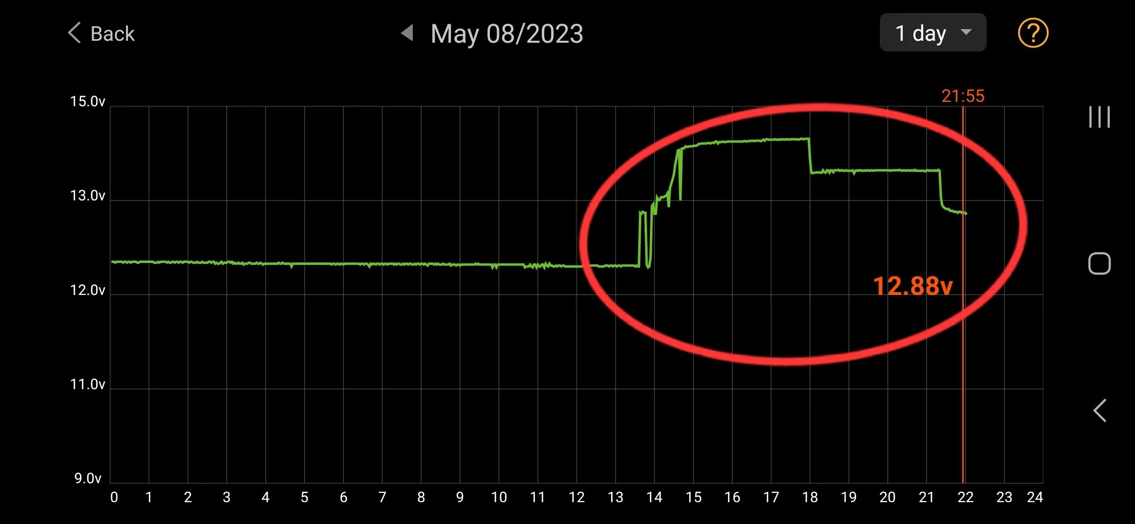

Before you get jealous that my Powerboost AGM is way healthier than perhaps yours, the app logs the battery status 24/7 and downloads to the app each time you connect. Here is today up to this moment
Ford F-150 Battery tender Screenshot_20230508_220232_Battery Monitor
The orange line follows your finger so you can get exact voltage values and timestamps.
The flat line is the truck sitting all day today up until about 1:30pm?
That's when I threw the charger on the battery and started a 10Amp smart charge on it.
Circled below is simply what an AGM smart charge strategy looks like. Took just over 7 hours.
Ford F-150 Battery tender 20230508_221223
It'll only take a few days for the Ford battery management strategy to drag the battery back down to the 12.3X region. But I have repeated this reconditioning exercise every few weeks in order to keep the factory battery healthy enough to stay above deep sleep or error triggering status.

I stated that once the SOC of the AGM reached a certain point, the DC/DC converter would ratchet down the voltage from 14.X to 12.X
And this morning, when I started the truck for my commute, the truck had recalibrated for the SOC as a result of the charging last night. It was 89% SOC. (Something the truck's battery management would not ever achieve on its own) The charging voltage was 12.7, just as I expected it to be.
But somewhere along on the commute the charging voltage increased to 14.X ?
And the SOC actually increased by 1% to 90% by the time I got to the office.

47 minutes.
After an external charger charging cycle I don't think I've ever seen the truck increase the SOC until it gets "dragged down" to ~80% or less.
And while I understand the sentiment that something is wrong if you need to trickle charge your battery to avoid any issues, I'd argue that even if putting a new battery in gets rid of the deep sleep or Auto-SS disabling, it's only a matter of time before the AGM is operating at a lower SOC than it did as a new battery. And that SOC is closer to the threshold of issues.
Or put another way, my personal opinion is that other than perhaps the trucks that get adequate daily usage, the AGM battery life in these trucks are getting taxed in a way that they won't have the lifespan that might be expected.
An occasional battery reconditioning or a trickle charger, depending on preferences, can extend that lifespan.
