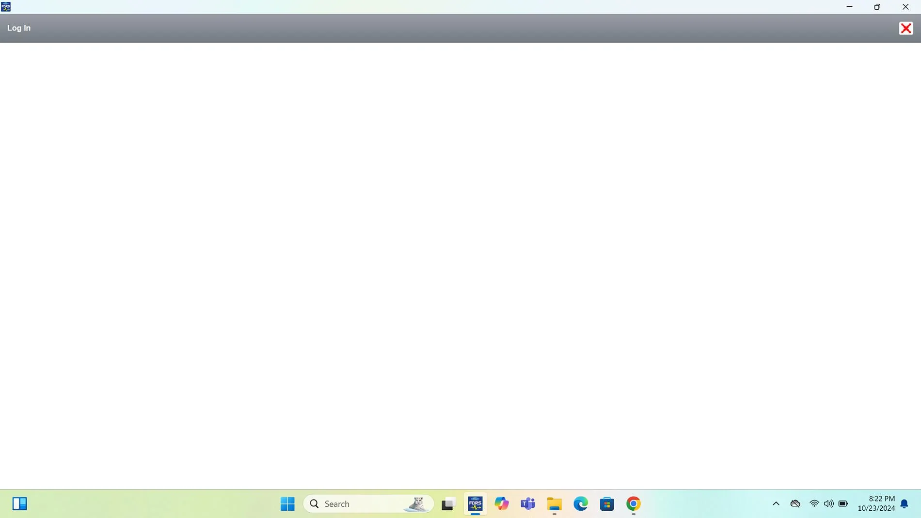

Anyone having issue getting into FDRS? I can't get the login screen to load.
Edit: Never mind, apparently it's just me.
