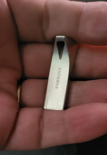

Ironically I have a Samsung thumb drive that I have been using for both of the Powerboosts I have owned, and now the Mach-E.
I carry it in my left pocket everyday everywhere. Not to be mixed in with the 10 other thumb drives in the backpack.
So I don't think brand differentiation is the whole story.
Make/model/firmware.....?
I do know our vehicles can be picky about such things.

I thought of you when he posted that. The funny thing is, I have the same exact 64GB Samsung drive and I've done all my updates on it with no issues. lol
Kanuck
Don
Aug 9, 2021
2,727
2,875
Winnipeg, Manitoba
Retired Electrician
Different firmware in the usb drives... or chip/s.

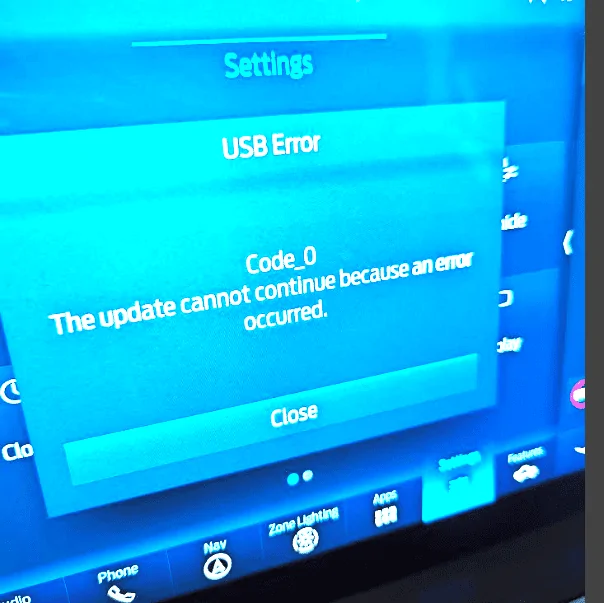

Today, I tried MicroSD card with USB reader
the vehicle started updating without "This USB is not supported" message After 3-4 minutes, I got below error
Might try a traditional USB stick instead. It shouldn't matter, but who knows. I've had weird errors trying to do updates over USB and had to use CAN bus instead. Prepare for hours of fun if that is the case.

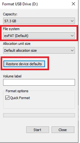

I tried 3 devices:
SanDisk 64GB flash drive,ASUS SSD 512GB and SD reader XD
None of them worked for me
One thing I noticed is when you format the drive, choose "Restore Default settings." If the drive automatically chooses something other than “exFAT” as the format, it may not work well. Even if you manually change it to "exFAT" it may not function properly for FDRS.
Having a USB drive that automatically choose "exFAT" by default works best from what I've seen.
I also wonder if this is why the dealers have issues updating systems and are not using the correct USB drives that FDRS is so picky about.
Ford F-150 ECU module programming guide using FDRS 1712436381223-a6
Here is another SanDisk drive I have that wouldn't update my cars when I used it. It doesn't default to "exFAT". Even if I changed it to "exFAT" it wouldn't update the vehicle in FDRS.
Ford F-150 ECU module programming guide using FDRS 1712437229371-tn
