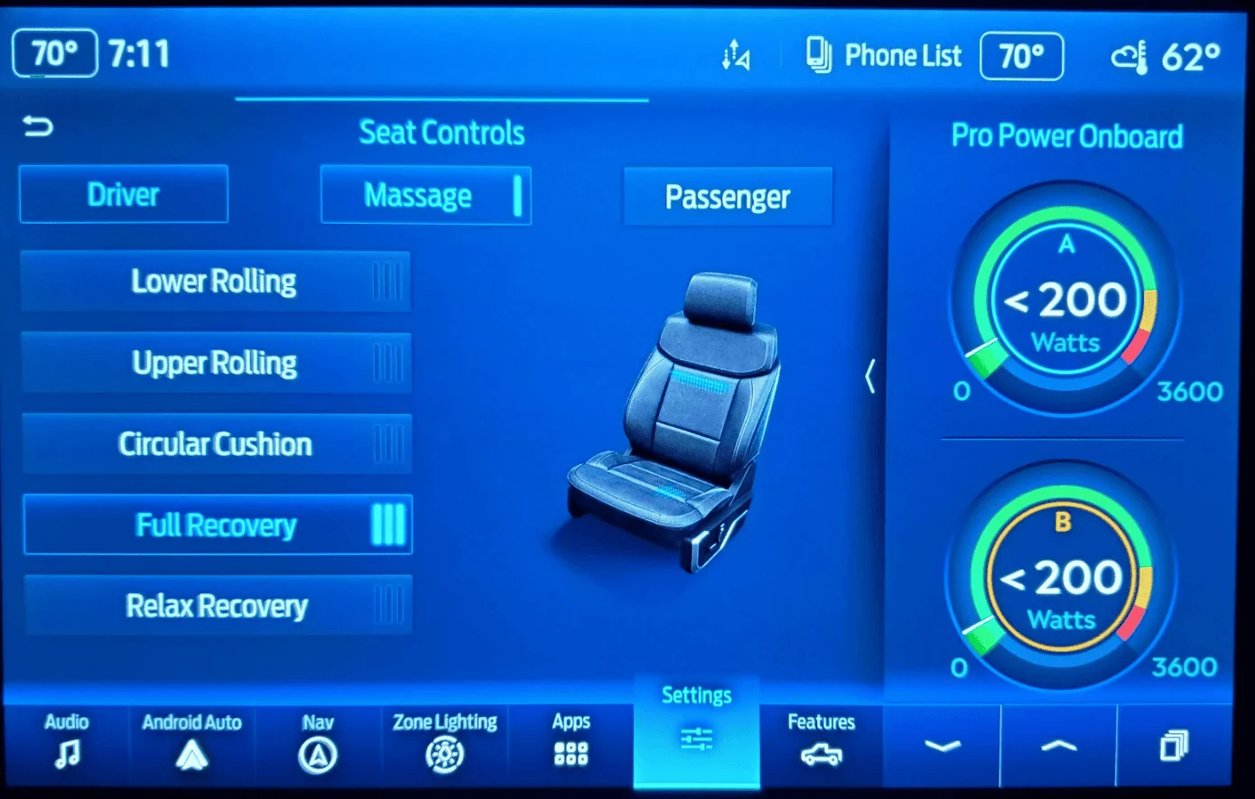

In the MME we got subtle differences in icon shadowing which includes the top bar. Hard to see it in the first pic which is previous (sun setting causing glare)

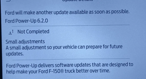

I believe this is 6.2
6.2
Oh, that's new. This means a new APIM OTA is on the horizon. 6.2.0 is for the GWM.
@Mike G has the OTA version for this in his queue now on his Lightning. He is waiting to see if it installs on its own to get the release notes before going the FDRS route. I'll let you guys know what it says when I have more info. It's just a matter of time before someone reports a new OTA.
Edit: The APIM OTA is not in his queue. We're going to have to wait a bit to get more details on OTA version of it. The update is 6.0GB's, so it's a big one.

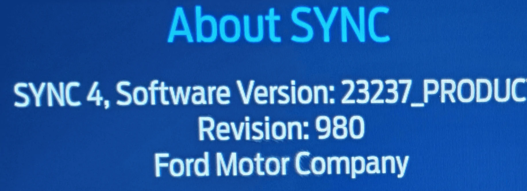

Anyone seen this when pressing the check for update tab? Looked at the Ford site and it reads "no qualified alerts found."
Ford F-150 ECU module programming guide using FDRS 1697736509515
Failed to mention, I did update via FDRS a couple weekends ago. I am pretty sure I did the GWM update. Current SYNC version is 23159 REV. 915
It looks to me like the OTA failed. 6.1.0 and 6.2.0 are both GWM updates, so maybe you did that one with FDRS. The GWM first popped up in FDRS at the end of September, so if you updated a couple weekends ago, you did 6.1.0 already.
Appreciate that info. It's weird that the Ford site doesn't show anything for OTAs. I'll have to see if it comes back around.

No the owners dashboard. But PTS is indicating that 6.2 failed as you stated. Reason:
Ah ok. Sucks that I was right about that. lol
