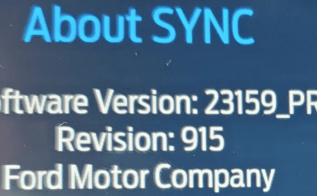

Here's PRE update
Ford F-150 ECU module programming guide using FDRS 1697579549910
Only 5GB in size roughly
Ford F-150 ECU module programming guide using FDRS 1697580718094
