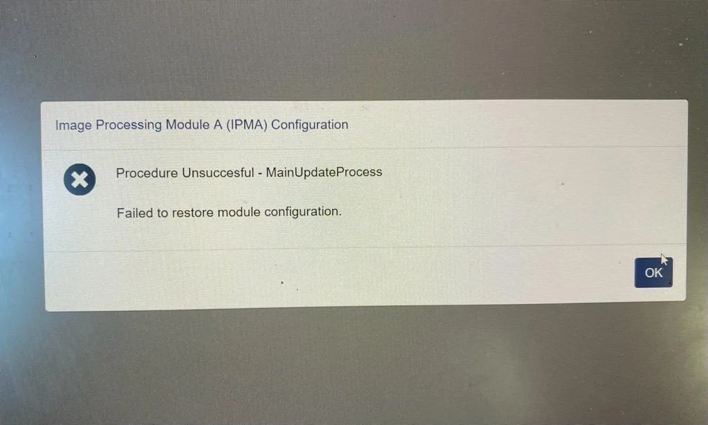

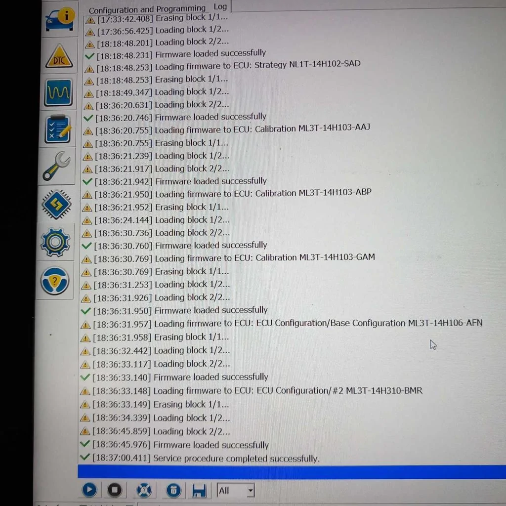

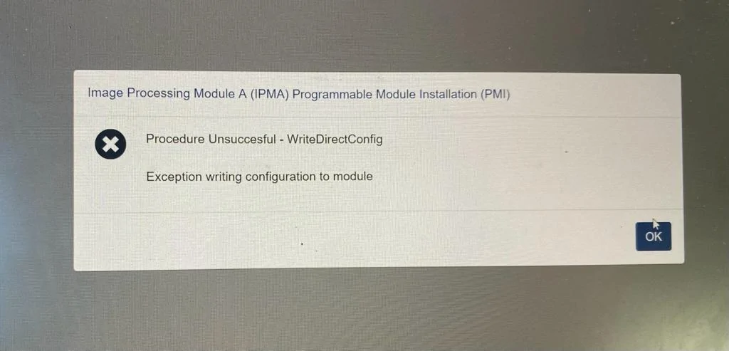

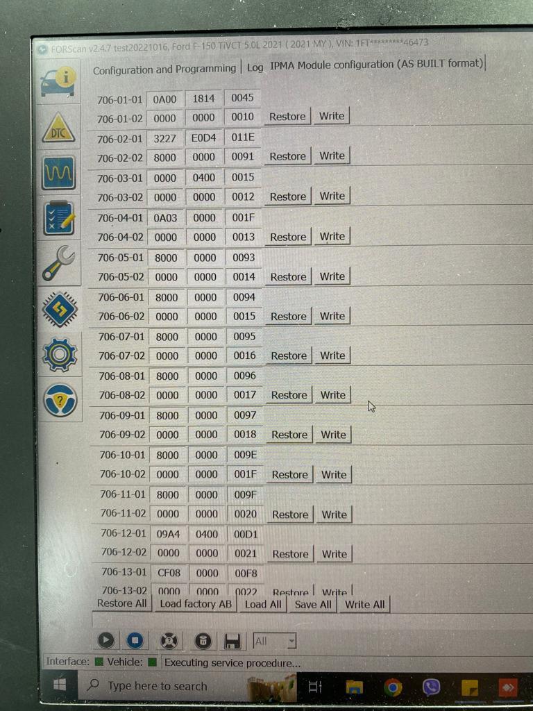

Hello everyone.
I have a problem with F150 2021 vin 1ftfw1e56mfb46473
I am unable to do PMI or module configuration via FDRS and I have got U2101 error in IPMA module
I tried reflashing the module with Forscan and it worked but the same error (u2101) persists.
Now I have updated GWM and IPC. Apim is left but doing it now.
the main error I am getting is: Procedure unsuccessful - RestoreDE0x_Range
I read almost all the posts in this group but all the advice didn't help.
Don't know what I could do more. Maybe Jesse-Infotainment could help? :)
Thank you
Ps. I tried to write asbuilt via forscan and I got a structure mismatch. Maybe this screwed up the module?
ps2. the front camera takes calibration and I don't have a front camera error, but u2101 gets me a front collision warning message.

Front camera refers to the lane keep camera.
incompatible config DTC (2101) and will cause the collision avoidance error and front cam error (lane keep/collision avoidance)
I am not clear on what youre trying to do. Just update it or are you trying to add something?
jeezz
Povi
Oct 12, 2023
Lithuania
Yes. I am talking about lane keeping camera. IPMA module is from this car, but it was tried in other f150, programmed and now returned back to this f150. Now I cannot do PMI or configuration via fdrs
