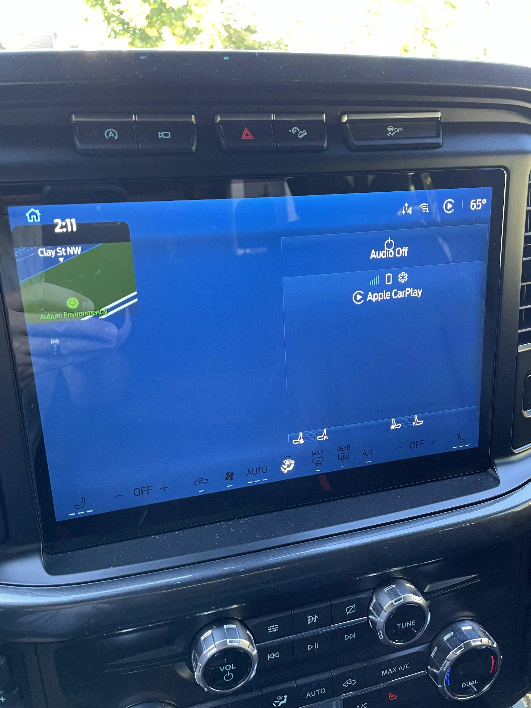

Hi Jesse-
I just did the new APIM and this is what my screen looks like now.
Did a reboot of the system a few times and it still looks this way…
Any ideas?
Ford F-150 ECU module programming guide using FDRS IMG_5597
TJSparky
Oct 18, 2021
525
473
WA
Disregard I fixed it.
For some reason it set the Unreal engine to 0000. Changed it back to 0001 and it’s back to normal.

Yeah I was going to tell you the Unreal was turned off..
