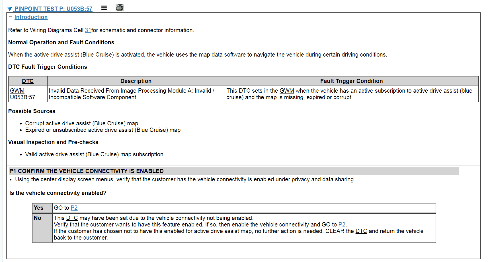

Morning @Jesse-Infotainment
I have error code U053B 57 48 on July 31st and again Sept 12th in my GWM. Would you happen to know what is causing this error?
That DTC isnt even in the DTC master tree.
I cant ffind it. I pulled your vin in OASIS and only DTC Ive seen reported is a IPMA loss of comm with ABS.

Thanks for looking. I will check in a couple of weeks if I get the same DTC again. I did do a ABS update Friday.
Here is what I found. Do you have BC enabled somehow?

But I don't have Blue Cruse or anything I need to get it working. I don't have Nav through Ford. I do use AA for nav. I also have Alexa active as well.

That says expired or unsubscribed BC as a possible cause. I guess wait and see if the rest of us start getting same error. ?‍♂

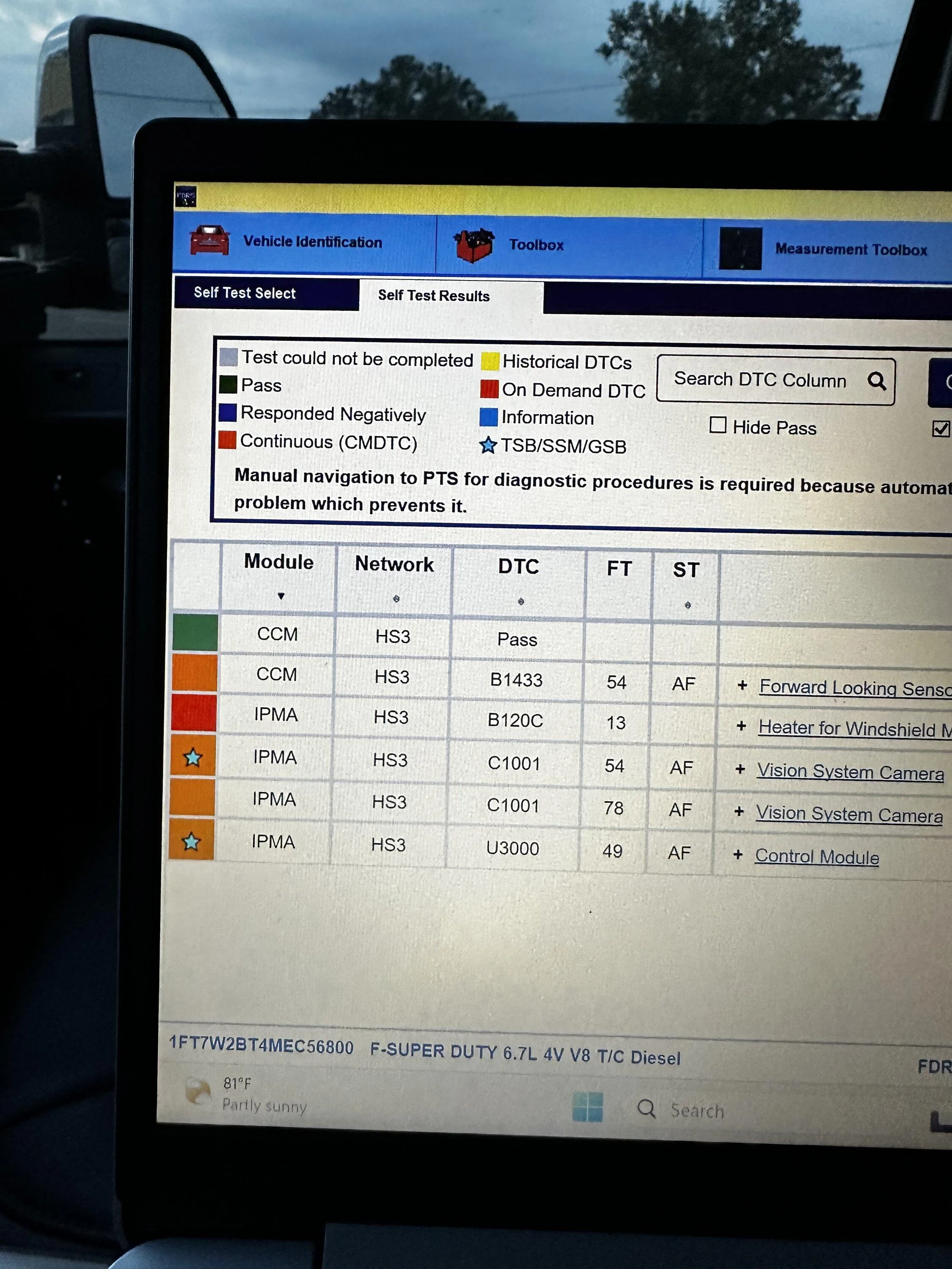

Hi guys. New to forum!! I have been reading these threads for over two weeks trying to sort out my problem and I’m still at a loss so figured I’d sign up to ask. I know this is a F150 forum but I do hope someone can help - I’ve got a 2021 F-250 that I put a 3.5” leveling kit and 37” tires on. Needless to say I have gotten the “cruise not available, lane keep unavailable, front camera malfunction”. I did the simplest first and tried to calibrate with forscan that led to “front sensor not aligned”. Getting DTCs in Ipma and ccm. Also tried to clear and reset AsBuilts in CCM. After no luck with forscan I’ve purchased FDRS and a wired mongoose adaptor. Per what I read - I updated all modules ( ccm & IPMA were up to date ). Tried a PIM on the IPMA and cleared all DTCs with no luck. Still where I left off. When running network scan - the IPMA and CCM come up grey as “not responsive”. I am at a loss and on a very long wait list at dealership.. any ideas?
If needed - VIN is1FT7W2BT4MEC56800.
DTC per forscan -
CCM - B1433:54-64 which is now B1433:54-AF.
IPMA - U3000:49-6c which is now U3000:49-AF

That is normal to get front sensor not aligned while doing the calibration. Did you allow the Calibration to complete?

I tried 4-5 times and the progress bar would never come off of zero. This was all with forscan right after problem started, I just updated and did PIMs etc last night so have not tried again. Longest I drove was about 30 minutes and progress remained zero.
Try in FDRS.

Alright. Attempted both IPMA and CCM alignments with FDRS. Neither would progress off of zero. Did PIM and Configuration on both modules as well as updated the height when prompted for the ipma calibration. This is where I’m at.
Can you let me Remote in.
