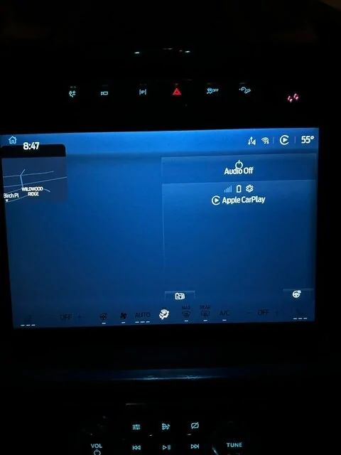

Ford F-150 ECU module programming guide using FDRS image0
It's been a while but I need this groups help again. My one year FDRS subscription was ending so I installed all remaining updates. Tonight I installed the APIM update G2171556. After the update my screen looks like this; the map is in the upper left corner and all my HVAC controls are grayed out. I'm assuming it's something with my as built. Can anyone assist? 1FTFW1ED9MFB59998
I tried a hard restart and a PMI
your unreal engine defaulted back to 0000. Go into Forscan and change it back to 0001
This happened to me too.
Do you think this will happen to all of us that have unreal engine and climate bar enabled? I 2ould have thought as our builds get update - changes back to Ford - that may have protected this but guess not.
