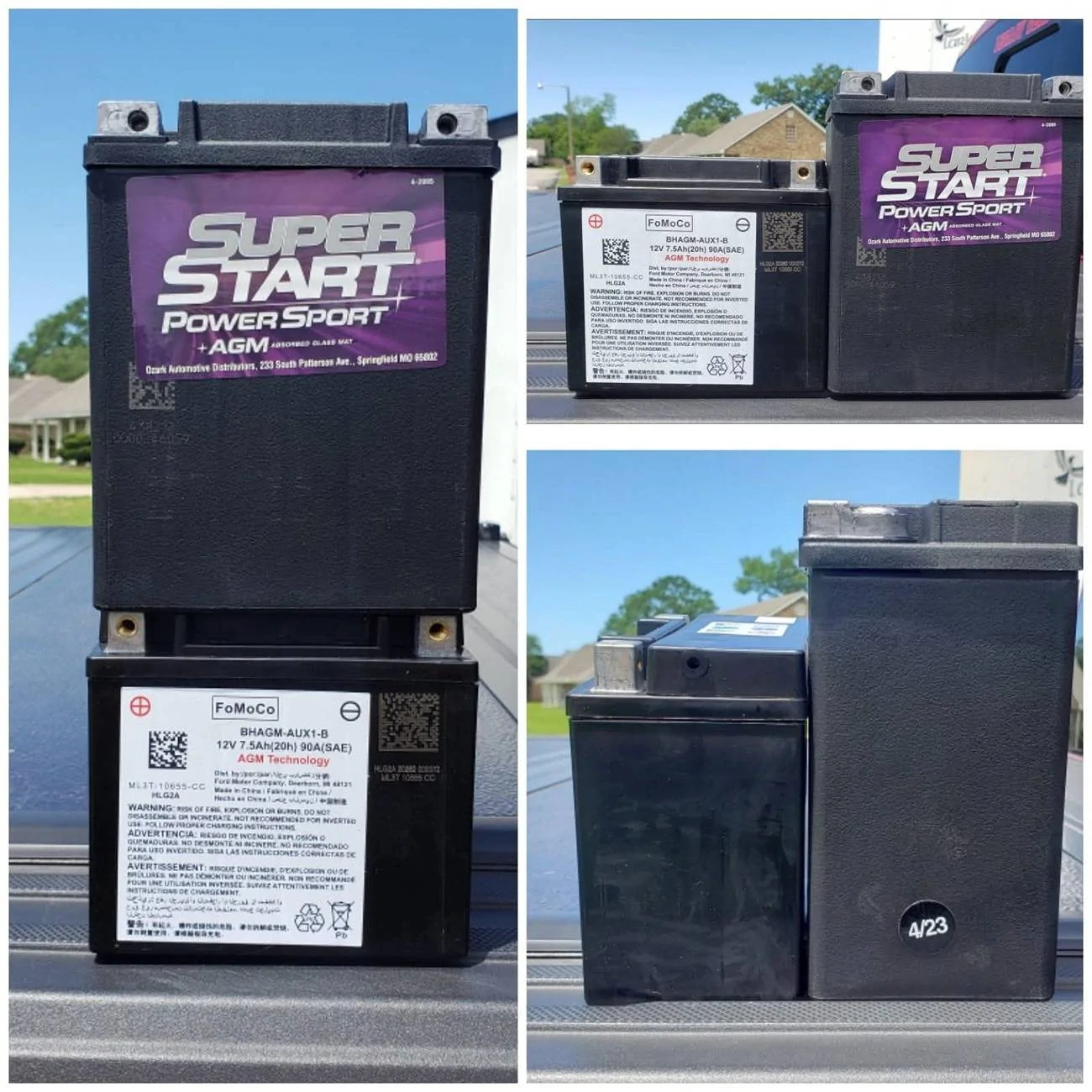

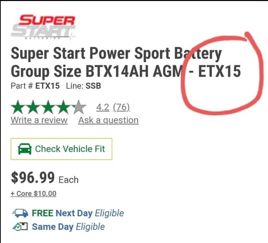

About 2 years ago I desiged a mod to fix this issue.
...which entailed replacing the stick 7.5ah Aux battery with a 14ah battery that fits in the stock location..
Hundreds of people have done my mod in the last 2 years, works perfectly..

AGM and LFPs aren't comparable in terms of what it does for the 12v bus.
LFP adds well over 20ah of reserve capacity before touching the starting batt that's sitting at 100%. If you take 20ah out of the factory config even w a 14ah AGM aux, you're down into 11.x volt range and modules are sleeping. It takes 20ah before I hit 12.8v.
Thank you, Tank! I will add this to my powerboost summary thread!
