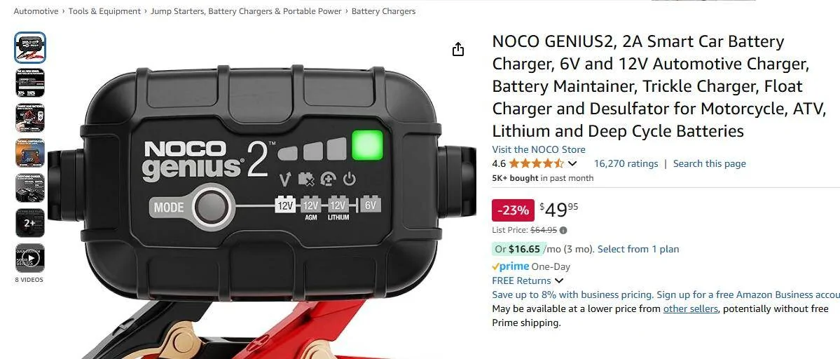

One of these, the 2 or the 5, another flavor/model of noco, or something else ?
Ford F-150 Testing an Aux batt solution... 1740309218223-pu
Ford F-150 Testing an Aux batt solution... 1740309124347-2

This is my exact unit but they've since come out with a more powerful one.
https://www.amazon.com/Black-Decker-BC15BD-Battery-Charger/dp/B00KNMKRU8/ref=sr_1_1?
Haven't had to use the regeneration mode on the truck yet but it has helped extend the life of several other batteries. In my old Class B, Garden tractors, boat etc. I just replaced a garden tractor batt that was 11 years old. Before I got this, I was lucky to get 3-4. It either works or it doesn't. 50:50 ish as to success rate.

I have both a 1amp NOCO and a 5amp
NOCO.
I use the 5A on the truck, the 1a takes care of my Toyota.
I prefer to use the low amp models to maintain a battery

If the main and aux batts are on the same bus, does using one of these chargers on the main also heal the aux at the same time or do you have to trickle both batts separately ?
