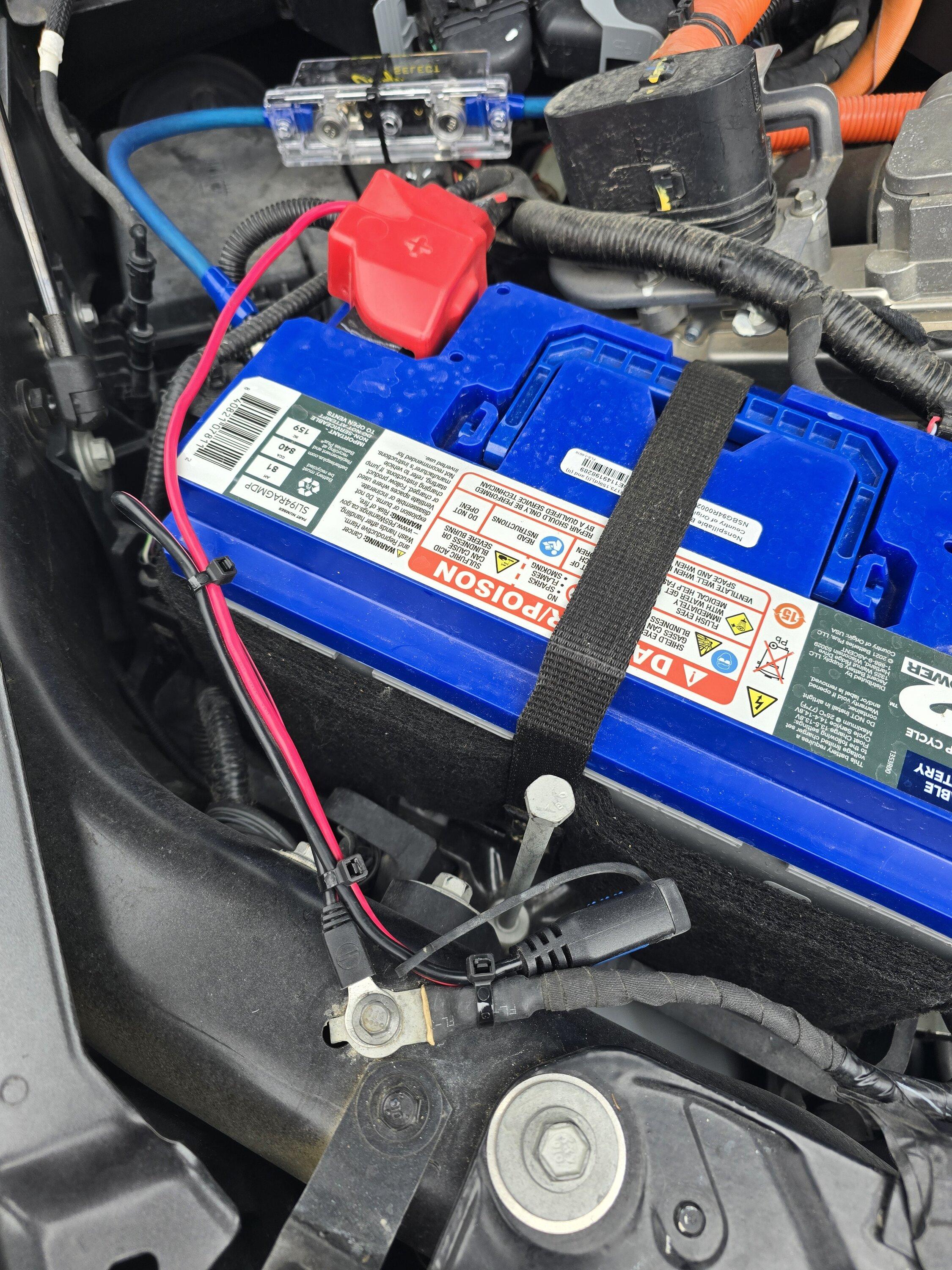

ok folks, So I went ahead and ditched the Ford provided motorcraft battery and went to Walmart for their battery ($190 for an A7 AMG) and after 5 days now, no problems. I have a battery monitor on my battery and my app says its' 90% all the time now. I have an ipad, fuzz buster, dashcam and flashlight all hooked to power outlets 24x7. I also did the reset I posted previously. I think I am back to focusing on other things now. ;) All good.

Turns out that my OEM battery was weak enough that the charging system was up over 15V trying to compensate. After changing the 12V primary battery to an X2 a couple of weeks ago, the battery monitor now shows a much "tighter" spread between high and low voltages, with the highs being a more-normal mid-14V range.
A weak battery is the root of all evil, not money.
