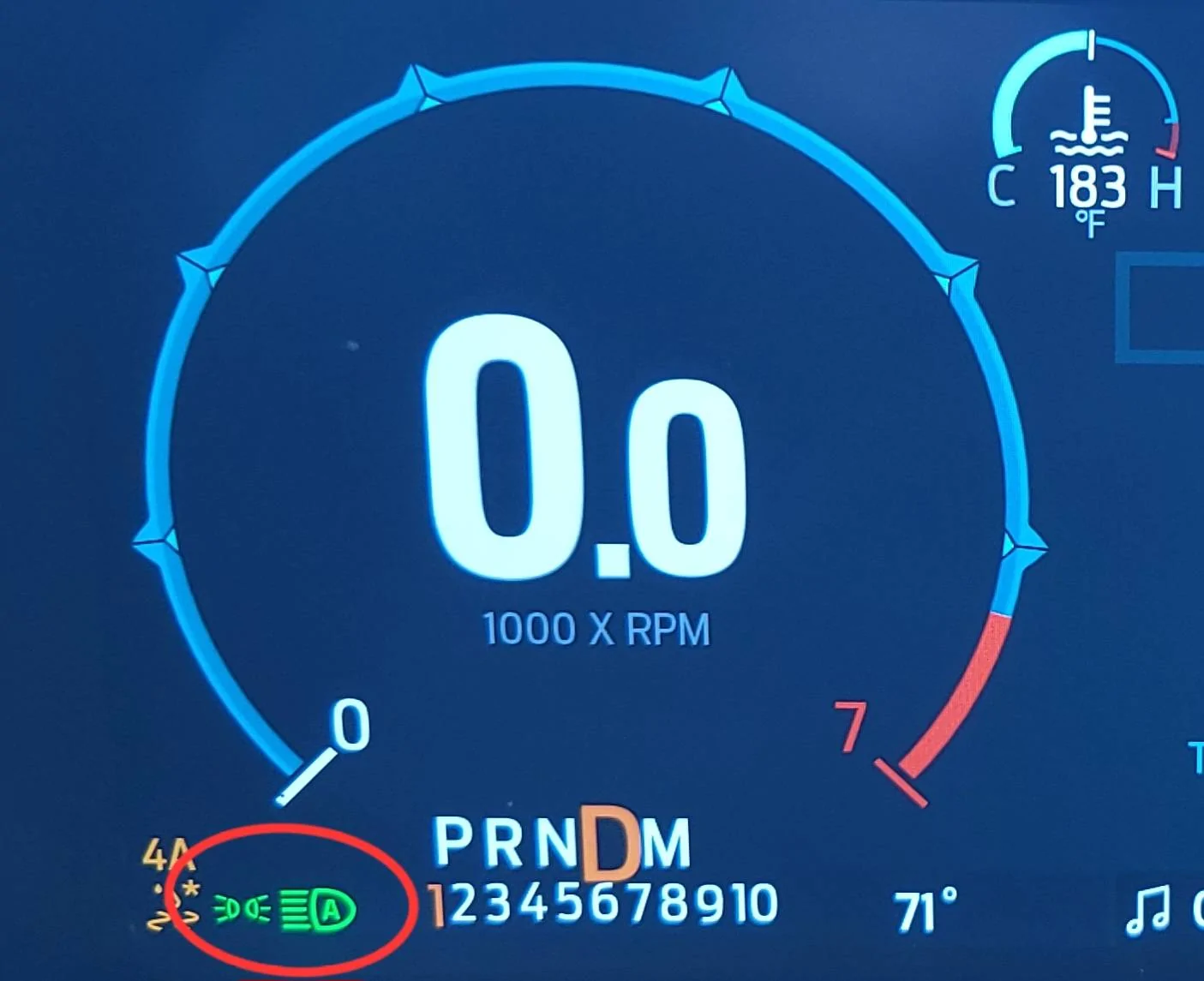

I've had the LED Projector Headlights / HCM installed and working properly with Glare Free for 2 years minus the height sensors - they are NOT required and throw a soft DTC code which I'm fine with.
I did this round of FDRS updates and one of them changed a setting and I need to figure out which one / I don't think it was the APIM. I went over the obvious ForScan changes that are required to enable Glare Free and everything looks good.

For the IPC indicating. I thought the matrix operation and/or dynamic bending didn't work w/out the suspension sensors. Green A is auto high whereas white A = fully dynamic.
Do the lights fully work otherwise? It seems that if it 'vanished', there was some communication between the the IPC/SCCM/HCM so it may be in one of those modules.

Why do my Glarefree seem to functioning completely, as well as the normal LED Projector features like auto-leveling and dynamic bending with steering, yet I'm all green in the IPC?
Worked 100% with the Green A,
lights swivel with steering wheel, smooth ramp to high beams once speed is reached, drivers side dims while passenger side stay on high beam with oncoming traffic.
With the time change I haven't had a chance to test in complete darkness to verify.
I really didn't want to make this a big deal just trying to find out if it happened to anyone else. I'm sure with the retrofit of the lights(that have been working for 2 years) something changed in one of the modules and just need to figure it out.
It's not something also that's top on the priority list but is a great feature to have and hope to help anyone else that come across this since these updates are fairly new.
Mine is the same way. All green is dynamic bending and white is auto high beams. I believe that's what the manual states as well.
