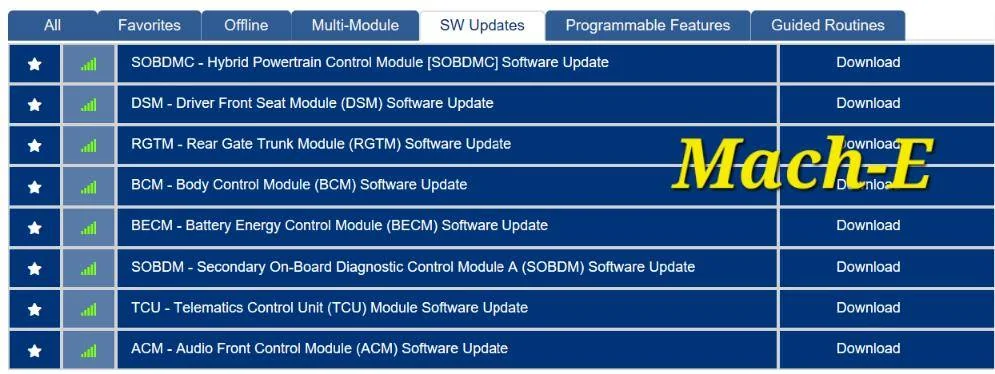

I swear I fully updated both the truck and the car just a few days ago. (I'm old, so I'm sure it could be a couple of months and still seem like last week)
I only licensed up because the mention of an APIM build actually compiled in 2024! I was begining to think we'd go a whole year without a build.
Anyways, I never ask Rugedraw to check my VIN. I just watch his relentless posts for all the other folks and then read between the lines. Still, I figured I'd have maybe a couple available for each vehicle.
Lo and behold
Ford F-150 ECU module programming guide using FDRS truck_unscanned09192024
Ford F-150 ECU module programming guide using FDRS MachE_unscanned09192024
One thing for sure is Ford shows no sign of slowing down on supporting further refinements to these vehicles. Of course OTA is a lousy delivery method if you want to keep up with the updates made available.
