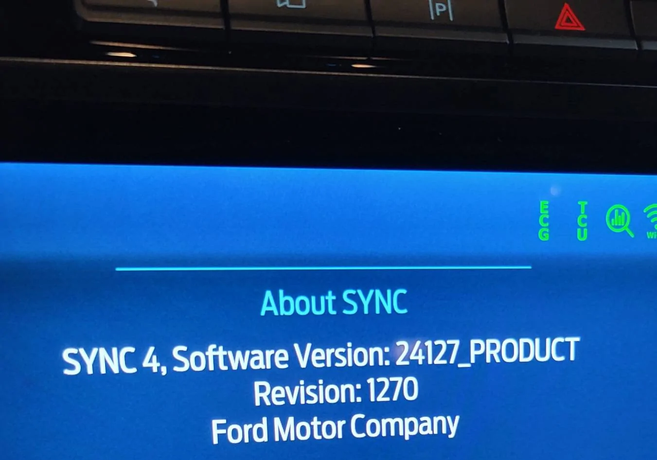

So I cannot get APIM version 24127, see below, until the locked BCM is completed OTA?
No, the APIM updates are not dependent on the BCM update. In my case, I got a GWM OTA update a week ago, and as soon as I scanned my truck with FDRS after I got that update, the new APIM popped up for me to do.

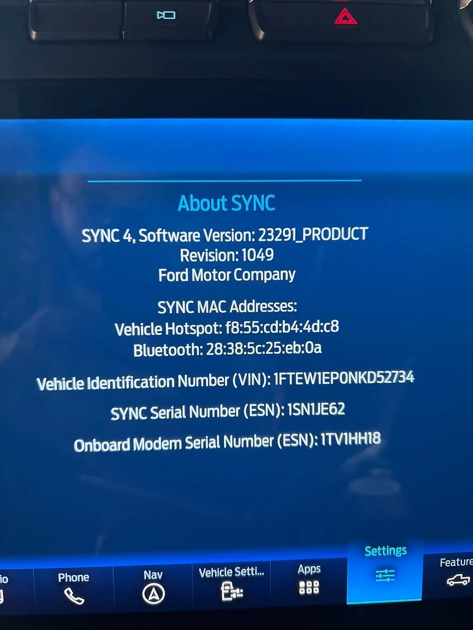

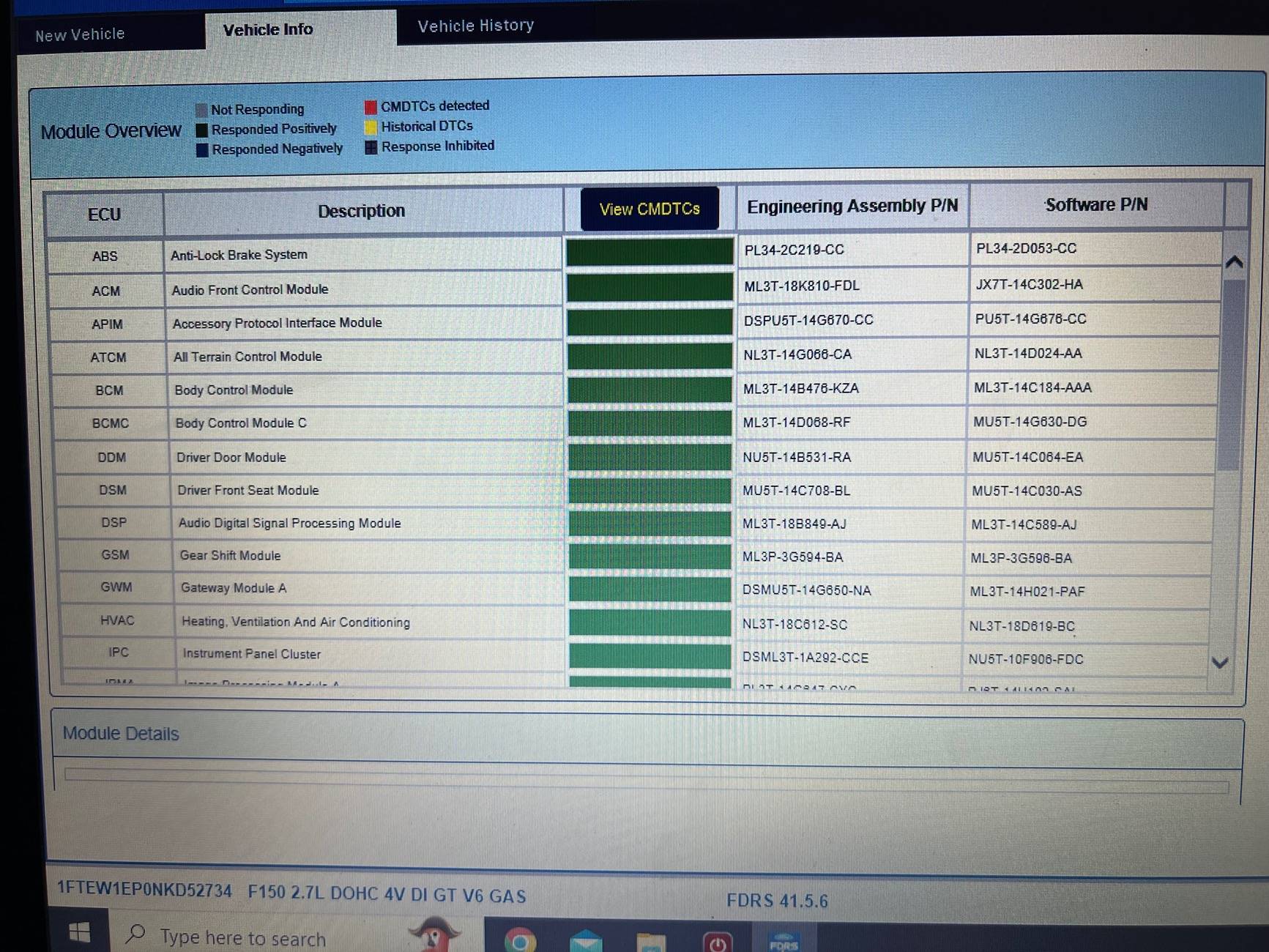

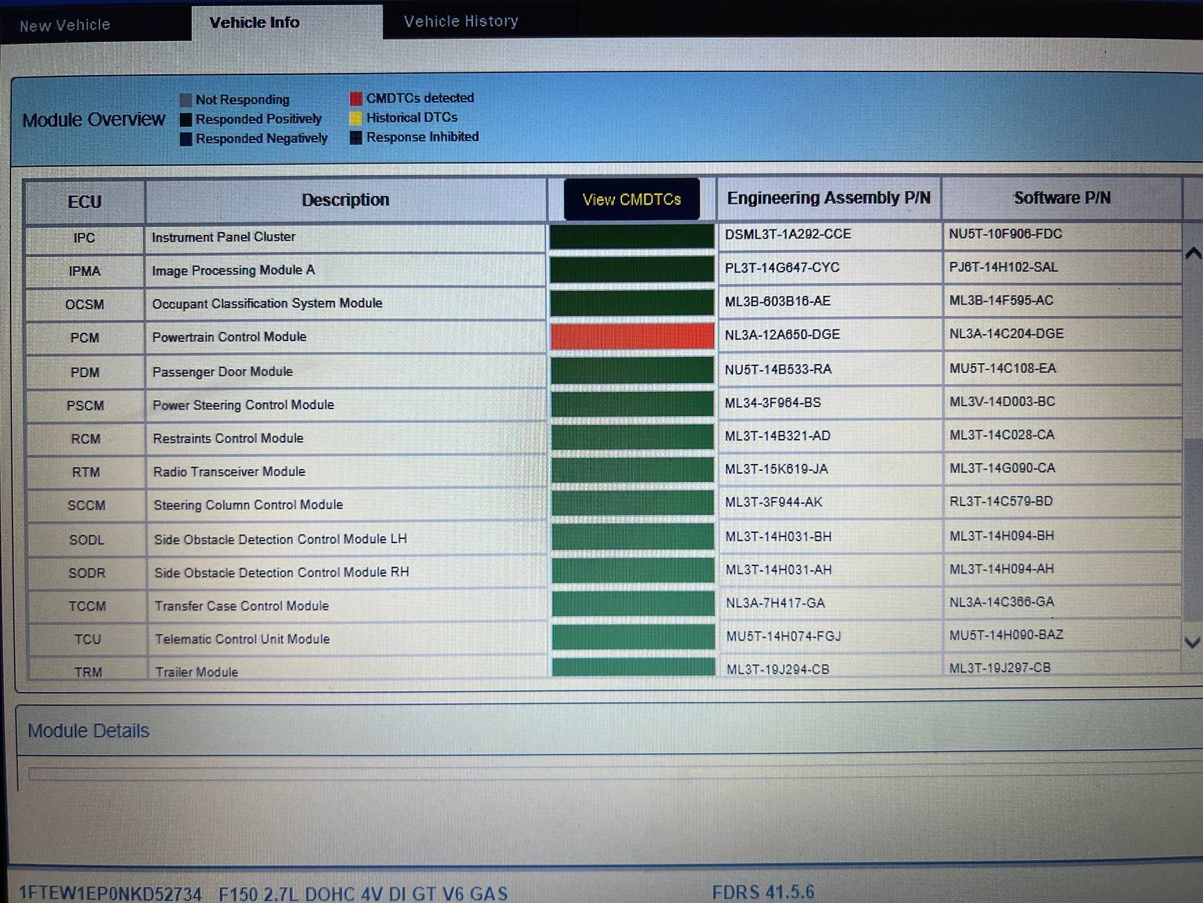

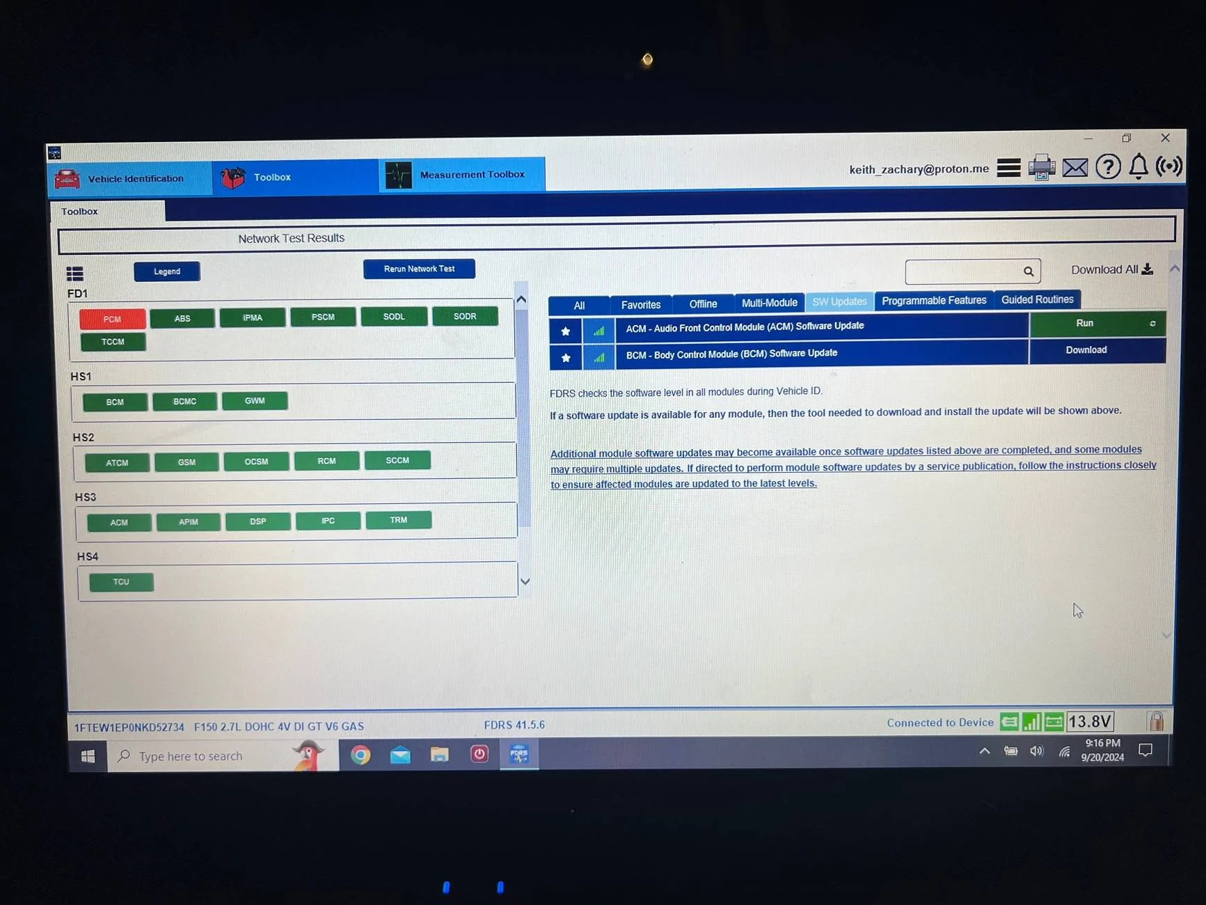

Got my truck Updated as far as I can. ACM seems to not clear no matter how many times I install it. Is that normal? And it looks like I’m behind on sync but there’s no update available.

That's normal for the ACM. What version of Sync are you showing? Dis you reset the APIM

I’m on 23291 and I don’t know if I reset it. I just updated it yesterday do I need to reset still?

I would reboot the GWM and the APIM and rescan the truck. I use forscan to reboot modules.
