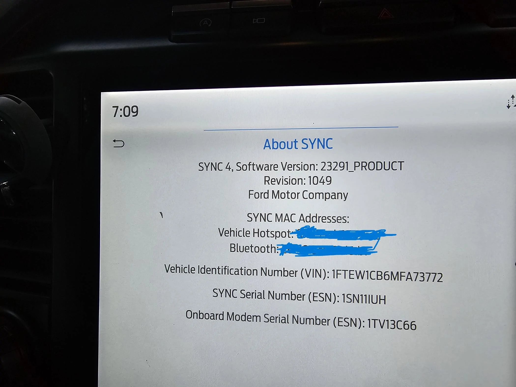

Yesterday was a long one, but I think I’m caught up.
Got down to the BCM, but @Jesse-Infotainment and @rugedraw helped me with a GWM module that was pending. Once that went in, these popped up in order:
DSM (drivers front seat module — the test is fun on that one, like a ride)
APIM (23159 rev 915)
GWM
TCU
GWM
Then a chat with @rugedraw and @Jesse-Infotainment got me:
GWM (provided)
APIM (23167 rev 926)
GWM
APIM (23291 rev 1049)
TCU
IPC (one display momentarily said, “Enable lane change asssist?” — so they are getting stuffed queued for later).
Now it’s just the BCM left, which apparently has bricked some trucks, so I understand the roadblock. I’ll do one more scan before the license runs out today. Right now all the self tests are green and everything seems to be up to date.
