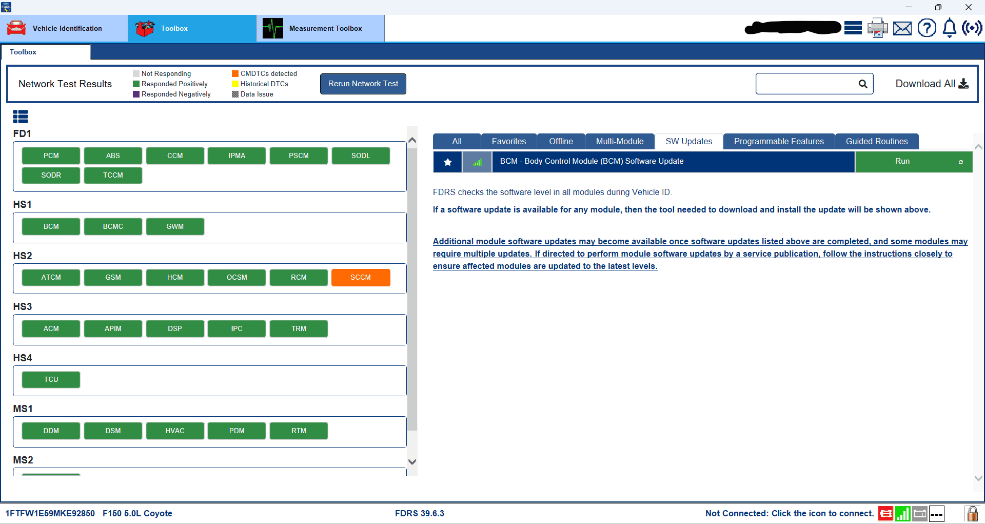

This is not your fault. The issue is on Ford's side. It is not releasing the next GWM you need to be able to continue through the process. You may have to keep my Mongoose a bit longer and get another license. Does your license expire tonight?
@sbi You will need help from Jesse to be able to progress, but I don't want to bother him now. Update every other module you can in the meantime. If you haven't done the PSCM/IPMA yet, those will take 3 hours so keep that in mind. Don't start either one unless you have the time to see them through.
I bought the license yesterday morning, so if I understand correctly it is valid until tomorrow night.
I went through and finished everything I had. The only thing in the SW Updates tab is the BCM which cannot be done because of the NATSF login. I had at least 5 new GWM that kept coming. I did GWM the first thing, then other modules and every now and then a new GWM showed up.
This is my current status after about a dozen "Rerun Network Test":

I saw the pic you posted. Unfortunately, people MUCH better at this than you or I have tried to do what you're doing and failed miserably. It's a matter of luck. If FDRS pulls the files, it pulls the files. If it doesn't, then it doesn't.
Attached is the TSB that has a maybe 10% chance of fixing the APIM.

I already messaged him, but this is a tomorrow thing at this point. Many vehicles hit a wall at Sync 23159 where the next GWM needed to keep going doesn't show up for some reason. In most cases, he can help. I'll message you.

My truck's updates are finally complete. Thanks again for all the help from everyone in this thread and behind-the scenes!!
