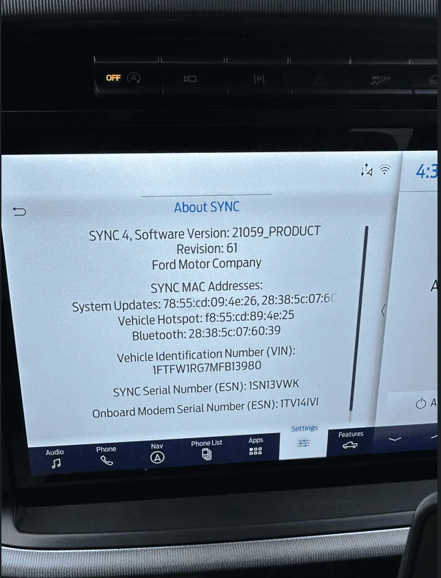

Good Morning, I'm new to this forum and believe I'm in the right spot to help sort out some update issues. I bought a 2021 Ford Raptor in January of this year, it only had 100 miles on it. I believe it was just sitting at the factory all this time as the carfax reports showed it was first sold(registered and sent to auction) with only 10 miles on the odometer in November of 2023. Truck has been amazing, however I've noticed quite a few minor annoyances with carplay, the cameras, etc. which I brought up to my dealer, but my dealer just said they can't replicate the issues and said my vehicle was up to date. After reading so much on these forums, I realized the dealer just doesn't want to spend the time updating... so with the help of this thread, I purchased the Mongoose and FDRS and proceeded to start updating yesterday. I definitely know something is not correct, but not sure what the issue is. My truck has a build date of 4/25/2021 - I only had about 10 updates to install yesterday which I completed in about 2 hours. Problem is many of my modules appear to have some errors and my Sync version is still at 21059 rev 61. The SW page in FDRS doesn't show any more updates for me. @rugedraw & @Jesse-Infotainment - you guys seem to be the resident experts here - any chance you can give me some advice on how to get the rest of the updates I believe I'm supposed to have? I fully expected to spend 15 hours or more on updates. I really appreciate any help you could provide!
btw @Jesse-Infotainment , its cool to see how many manufacturers of vehicles you are involved in - I bought a apple carplay upgrade kit for a 2015 GMC Yukon quite a few years ago off your website; that did work out perfectly for me - so thanks!! haha.
VIN - 1FTFW1RG7MFB13980
Welcome to the forum. This is definitely a Jesse issue and goes beyond my scope of knowledge. Allow him some time to respond. If anyone can fix it, he can.

The only time something will show in vehicle history is if somebody pulls up your truck in PTS or does anything with FDRS.
Right now, there is something wrong. I don't know what it is, but you are on Sync 21059 which is the same software your truck left the factory and I don't remember ever seeing that Sync version before. I don't know if the issue lies on your truck itself, or on the server where the next update you need to progress is not showing for some reason. As far as I know, the Raptors don't have any different sync versions that the regular F150's. I would try messaging Jesse on Monday when he is back in the office and has access to all his resources so he can take a look.
