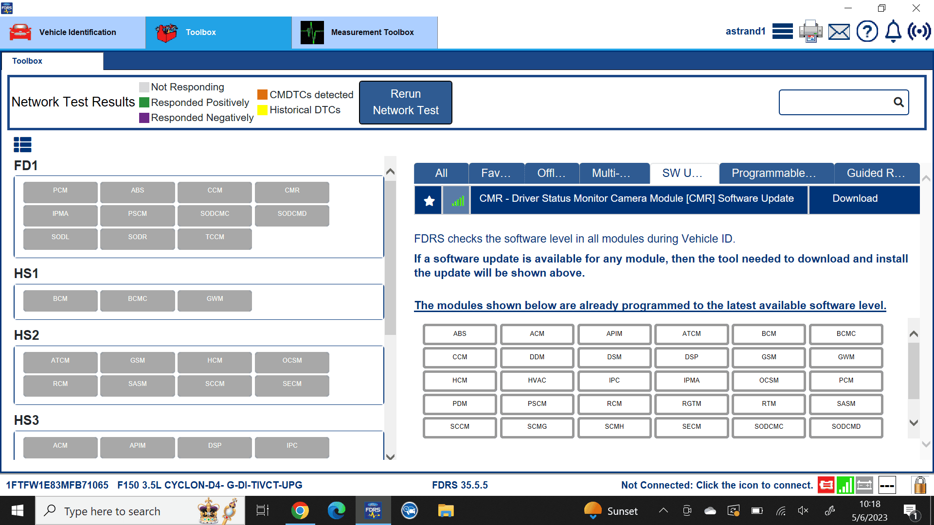

To anyone that has done the latest CMR update that has popped up for our trucks: How long did the update take?
I ask because I am taking my truck to the dealer on Thursday morning for routine maintenance, and I am going to present a valid customer complaint to them to get them to recalibrate my cameras and IPMA. I wanted to see if I can bribe the tech to do the CMR update for me, too. I'd rather spend $50 getting him/her a nice bottle of whiskey or whatever than give Ford $50 for another 2-day license.
What is CMR?
I did every update available and don't recall that showing up.

I don't have blue cruise so that explains not having it.
Before doing all these updates the truck would dang near drive itself. Now it's more annoying about me wiggling the wheel to know I'm there. Seems they cranked up sensitivity on one of the updates.
Camera Module Rear.
My truck has one pending.
This bad boy right here.
Driver Status Monitoring Camera. ?
It ain't looking at your rear.
It's focused on your eyes.
And it's a nagging little witch too
Well, FDRS can say whatever it wants, but CMR is camera module rear. lol

@rugedraw I did a CMR update on April 25th along with a bunch of other updates. I did the newer one last Wednesday evening, and it took around an hour and a half if I recall correctly.
