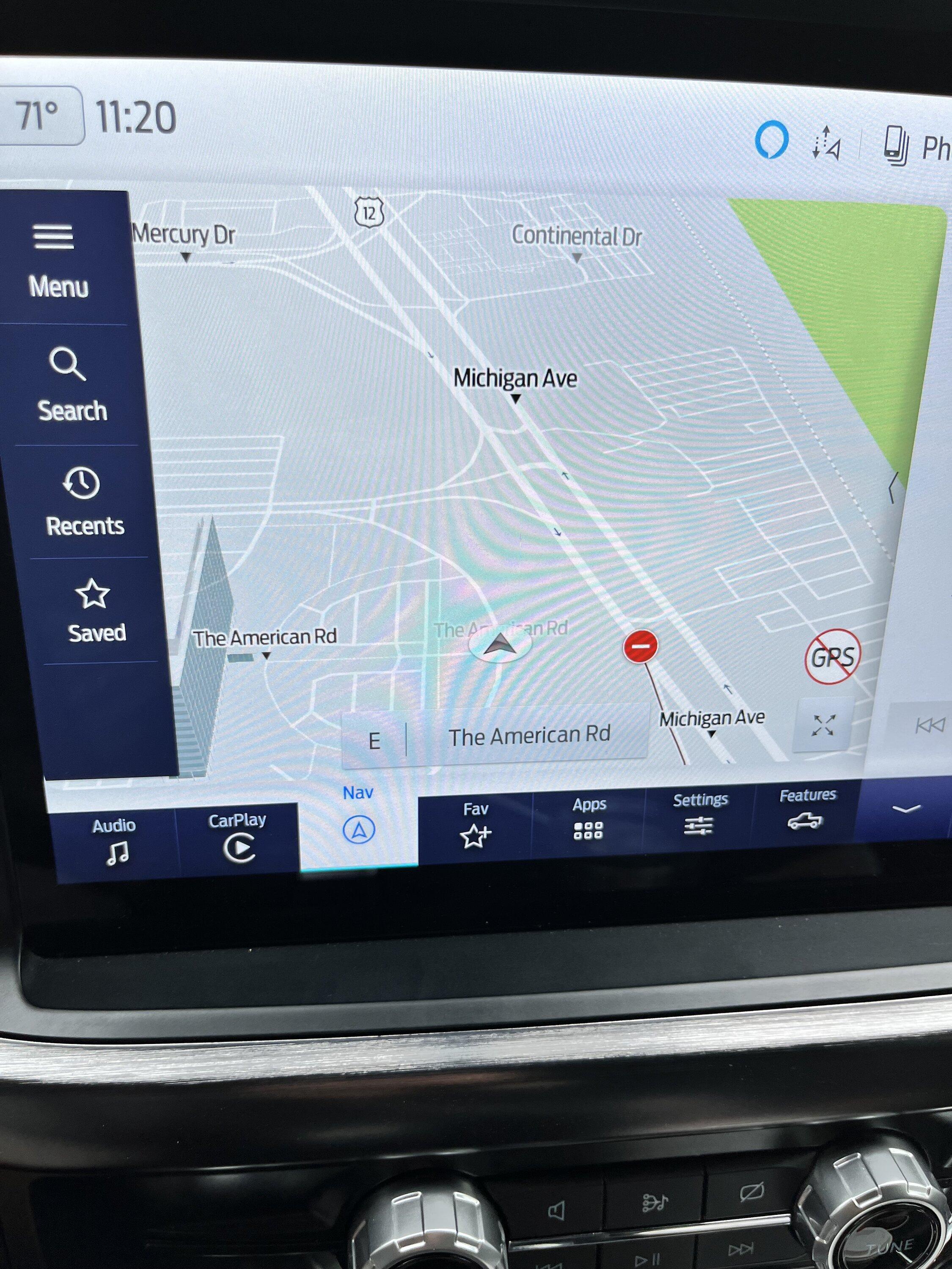

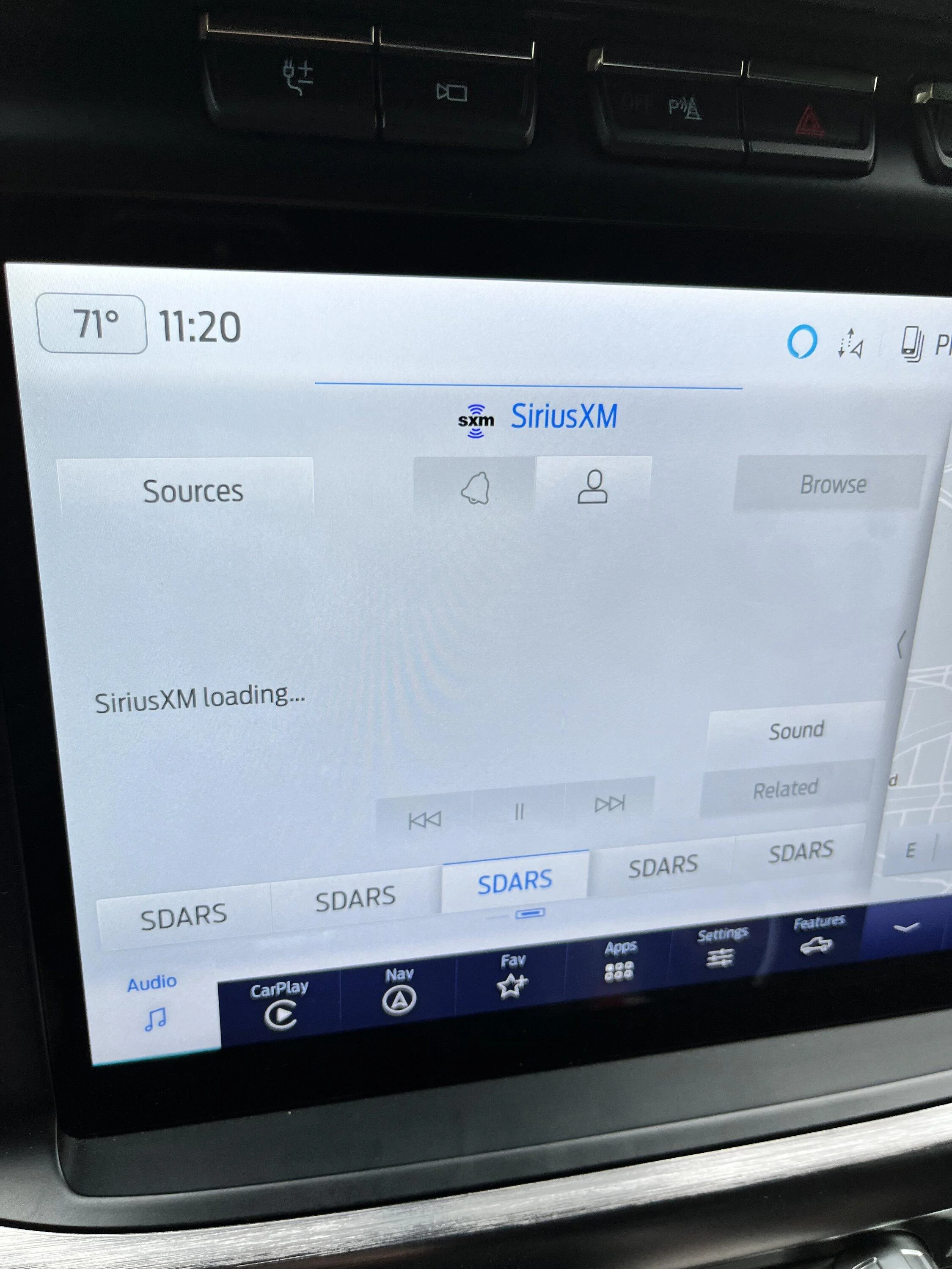

Anyone have an issue where Sat radio (just says “SiriusXM Loading) and Nav (the no gps logo) not working after going through all the manual updates?

I believe that is corrected with restarting modules but I can't recall which one this is still new to me. Forscan can do it and it's probably in FDRS too.

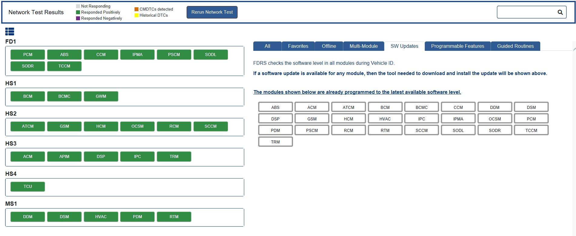

Screw you Ford, I fixed it myself. :cool:
I believe I have everything now except the newest IPC update in May.
Now just wait and see if I get any updates in future.
Note for those having recent issues I have not yet encountered any problems with GPS or Sirius.
Both appear to be 100% working, listening to Sirius now as I get ready to unplug everything.
My update timeline....
When USB updates actually work it was a smooth process.
Two updates give me USB Error 0 so was forced to CAN bus IPC and one GWM update.
Saturday...
22177 sync version at start 10:30AM
DDM Drivers door
PDM Passenger door
PCM Powertrain
ABS
GSM Gear shift
SCCM Steering column
BCM body control
CCM cruise control included these...
IMPA image processing (3 hours)
PSCM power steering
Then...
IPC instrument panel (CAN bus, 6 hours)
GWM gateway (USB)
APIM sync version 22192 (USB) 10:30PM
GWM gateway (CAN bus, 3 hours) 1:30AM
Sunday... Late start around noon.
APIM sync version 22293, skipped over 22228 (6GB USB, Alexa update) 2:40PM
Ford Pass message 3 years Alexa 2:43PM
TCU Telemetrics (USB)
GWM gateway (USB)
APIM sync version 23031 (6GB USB)
GWM gateway (USB)
TCU Telemetrics (USB) 8PM
