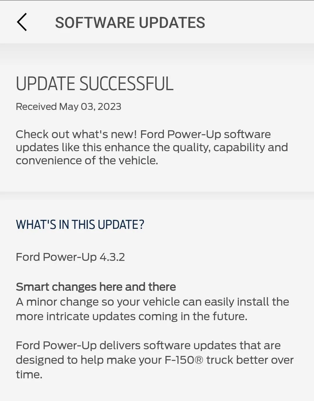

A couple weeks ago I was able to successfully get my truck fully upgraded, but in the process I started to get an error: "Pre-Collision Assist Not Available" which means my Adaptive Cruise Control and BlueCruise won't work (2 steps forward, 1 step back :rolleyes:)
I found on this thread that @StangTech had the same issue and resolved it by loading the factory as built configuration for the IPMA module. Since my DTC code is the same (IPMA U2101:00), I figured I would try the same fix. Unfortunately - no luck. I'm still getting the Pre-Collision Assist error.
What is really weird is that after loading the factory as built configuration (I had Forscan download it), I got an error when I get to write the updated configuration:
Ford F-150 ECU module programming guide using FDRS Screenshot 2023-05-03 134438
This is what that block looks like:
Ford F-150 ECU module programming guide using FDRS Screenshot 2023-05-03 153153
I went ahead and clicked yes to continue. Was that a mistake?
Then when I got the same "Pre-Collision" error, I decided to try and load my backup configuration when I first set up Forscan, but it won't load. I get this error:
Ford F-150 ECU module programming guide using FDRS Screenshot 2023-05-03 153113
@Jesse-Infotainment - any ideas/wisdom you can share?
My VIN is 1FTFW1ED0MFB61851
thanks!
