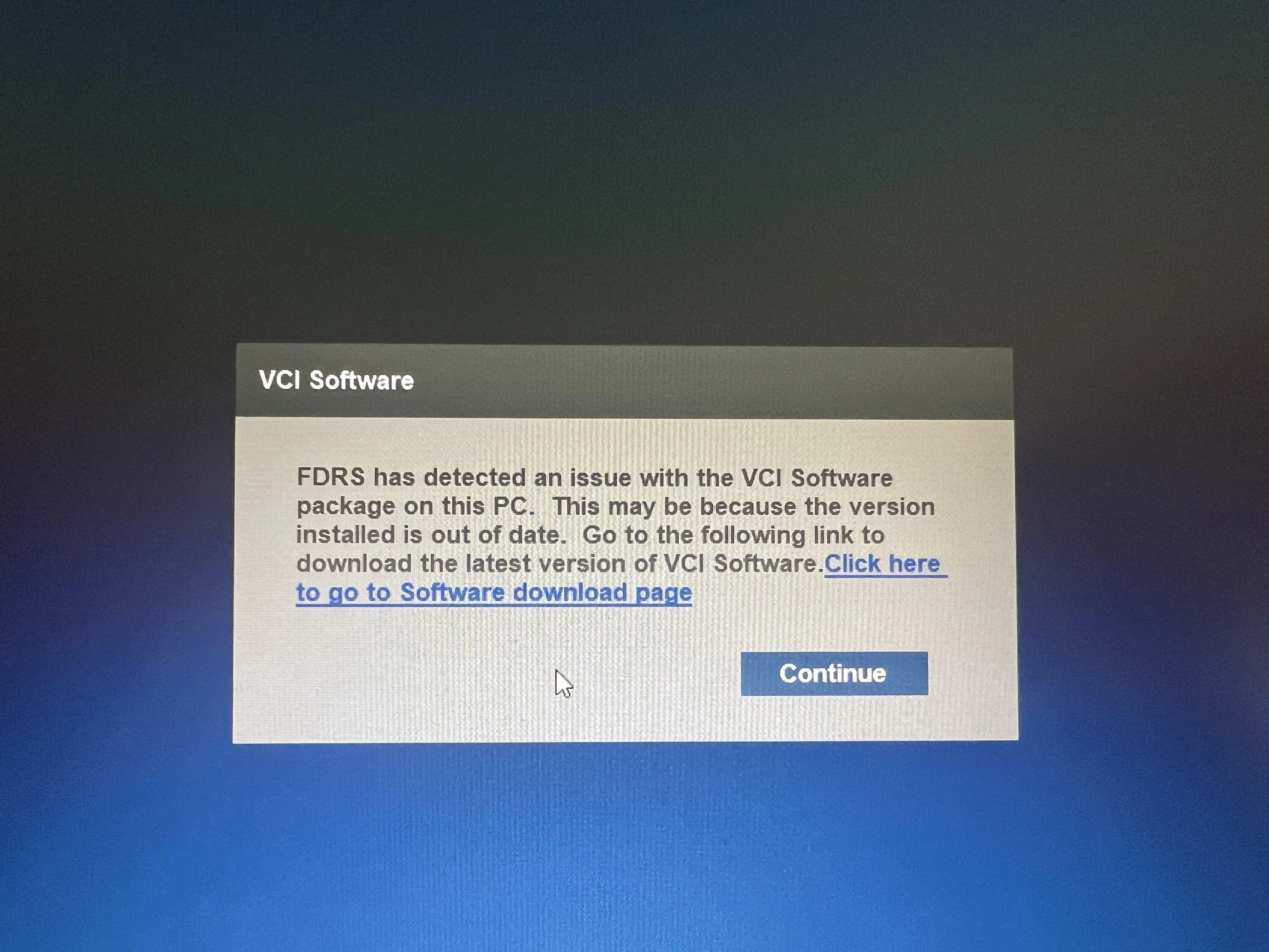

I have my Mongoose cable and installed FDRS. When opening the software I’m getting this error. I’ve tried to download the VCI software from the website and it’s not working. My computer is running Windows 11.
Ford F-150 ECU module programming guide using FDRS IMG_4697
Ford F-150 ECU module programming guide using FDRS IMG_4696
