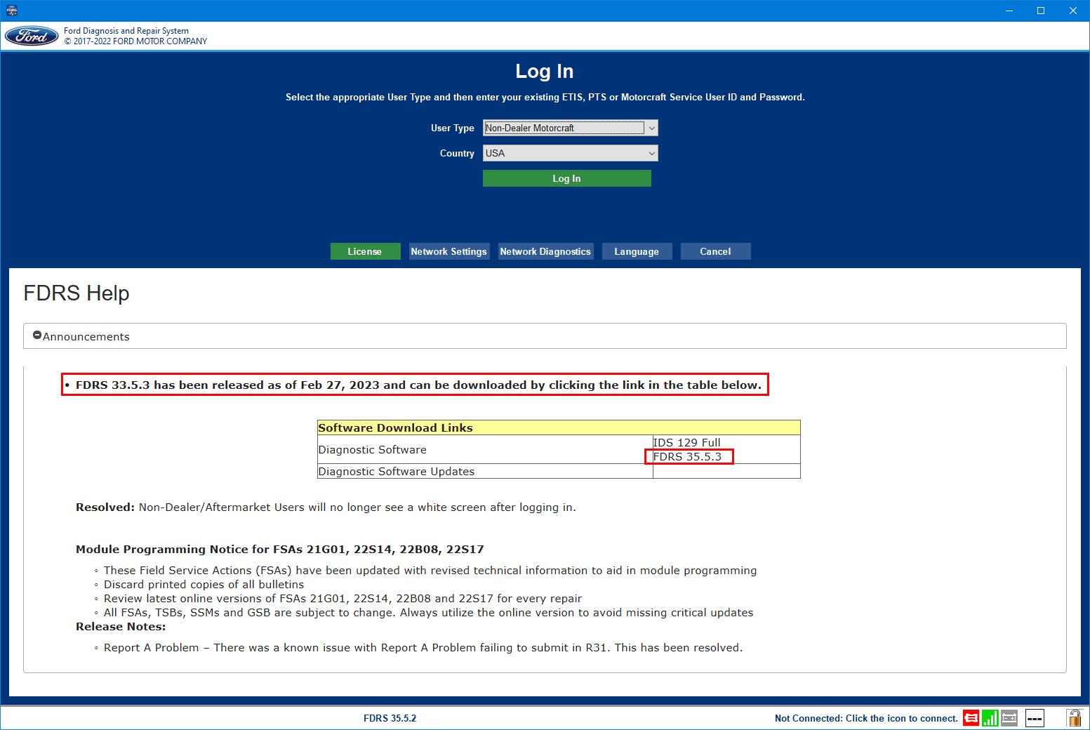

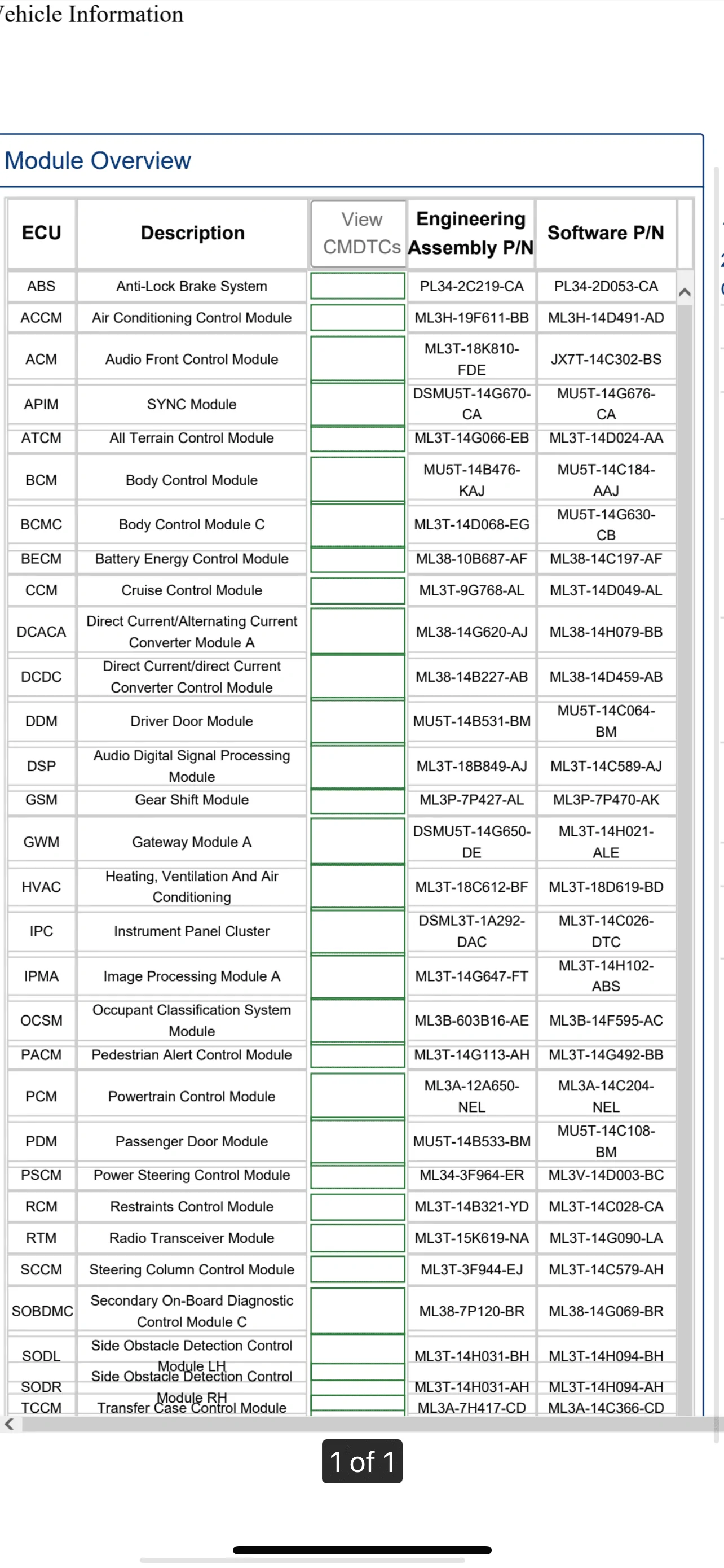

New to the forum here.
I have a ‘21 XLT PB 302A with quite a history. It’s a Job1 truck built in March ‘21. I took delivery in July ‘21. A few weeks after taking it, I noticed the connected services didn’t work. The dealership applied a software update which fixed the connectivity issue… but disabled my heated seats and rear defrost. That became a 5 month saga that ended with a Lemon Law suit, a check from Ford, and a repaired truck (the software they applied for the connectivity issue was for an Ecoboost power train, not PB).
Fast forward another several months and I discovered it wasn’t receiving any updates. Took it to another dealership (we moved), and they diagnosed it as a bad APIM. They replaced it, and while it was in the shop, I got an app notification about the update. That was May ‘22.
On to now: I am still not receiving updates. My truck shows software version 21223_PRODUCT, while PTS shows a previous version. I recently updated all modules wit FDRS/Mongoose.
Everything worked except the APIM. I was able to create the USB. It begins Updating, but eventually I get a Code_0 USB error. Sometimes the error comes up in about 3 minutes, sometimes 20 minutes, or somewhere in between. I’ve tried 2 flash drives from 2 manufactures.
I’ve heard there may have been some bad APIMs from last year. Could that be the case?
1FTFW1ED0MFB41289
Ford F-150 ECU module programming guide using FDRS 4065159F-FC58-4E65-BAE5-38037EE87F13
Ford F-150 ECU module programming guide using FDRS 2AC6989D-A3E6-4D10-976C-1B077C914A6B
Mike G
Jan 6, 2022
511
382
N. AL, USA
2022 F-150 Lightning, 2023(J1) Mach-E GT-PE
1FTFW1ED0MFB41289
