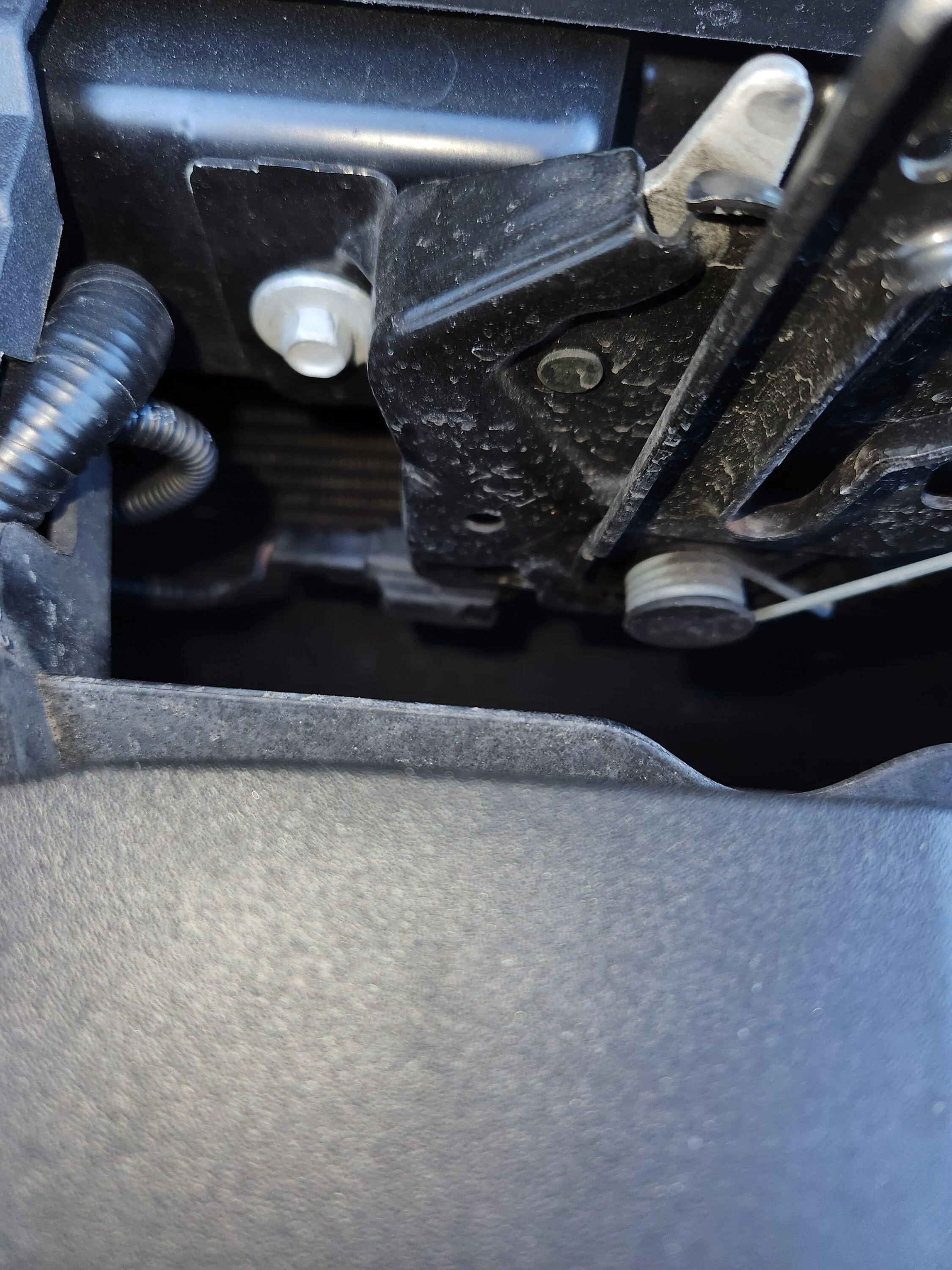

A little off topic... Where would I find the switch that tells the truck the hood is closed. I have an update ...1007... And it says it can take upto 38 minutes...want to have my charger connected but the update needs the hood closed. I want to bypass the switch and make the truck think the hood is closed.
It's actually under the hood latch. ?
Ford F-150 ECU module programming guide using FDRS 20230226_164909
1007 is a quick update, unless your battery is very low it should be fine. It took my Lariat PB about 15 min.
