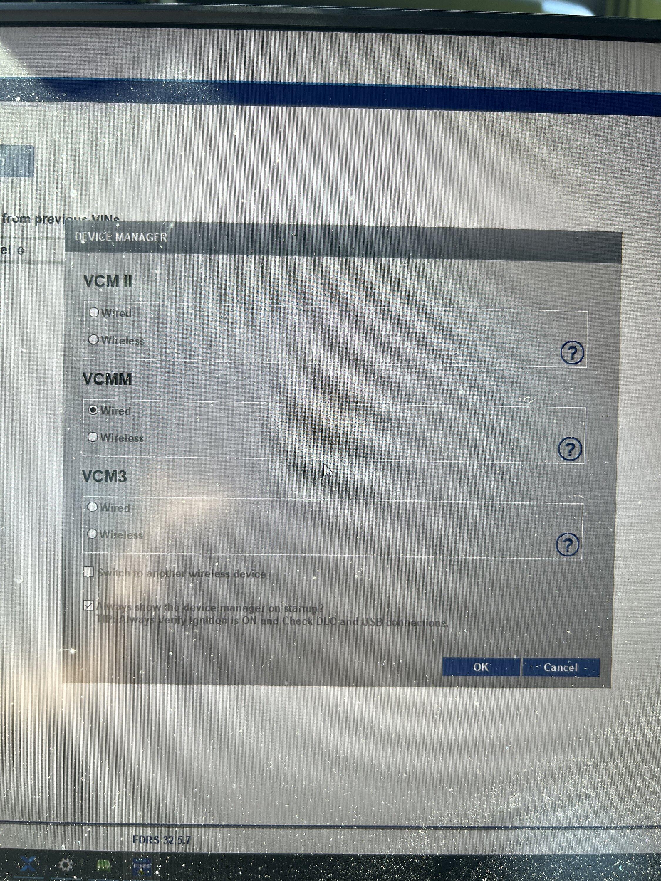

Other devices will not show up for me in FDRS device manager, not sure what I’m doing wrong or was there an update?
What VCI are you using? Did you run the installation program for it before running FDRS? You need to install the drivers before FDRS will recognize the device.
If you are using the Mongoose, you can download the set up program here: https://www.opusivs.com/support/downloads?hsLang=en. Then go to the support tab and make sure the drivers are working correctly. Then go back to FDRS and see if the Mongoose is now recognized.
Using vcx nano, installed software and drivers for Vci.
I think your missing the J2534 pass-through software

I installed the j2534 software during the install of VX manager.
Run the Mongoose set up software I provided the link to. It has the drivers specific to the Mongoose. The VX Manager won’t get you the Mongoose drivers.
Ah. I wouldn’t advise using the Nano, particularly if your truck has BlueCruise, but if that’s what you have you should take another read through the instructions. It sounds like you missed a step somewhere. I remember the Nano installation being less than straightforward. But @iceman77 did a good job of laying everything out.
I’ll uninstall everything and try again tomorrow.
