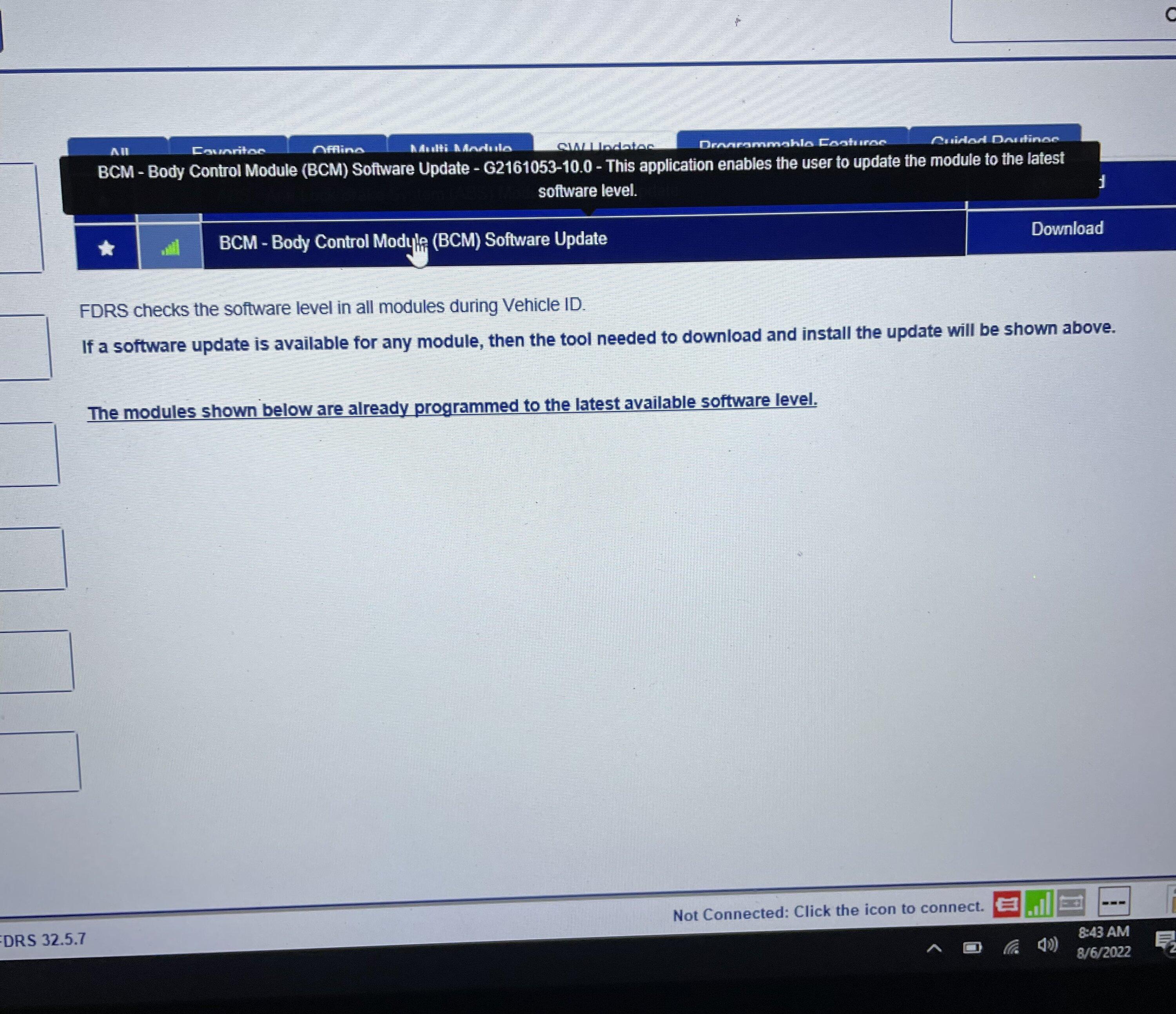

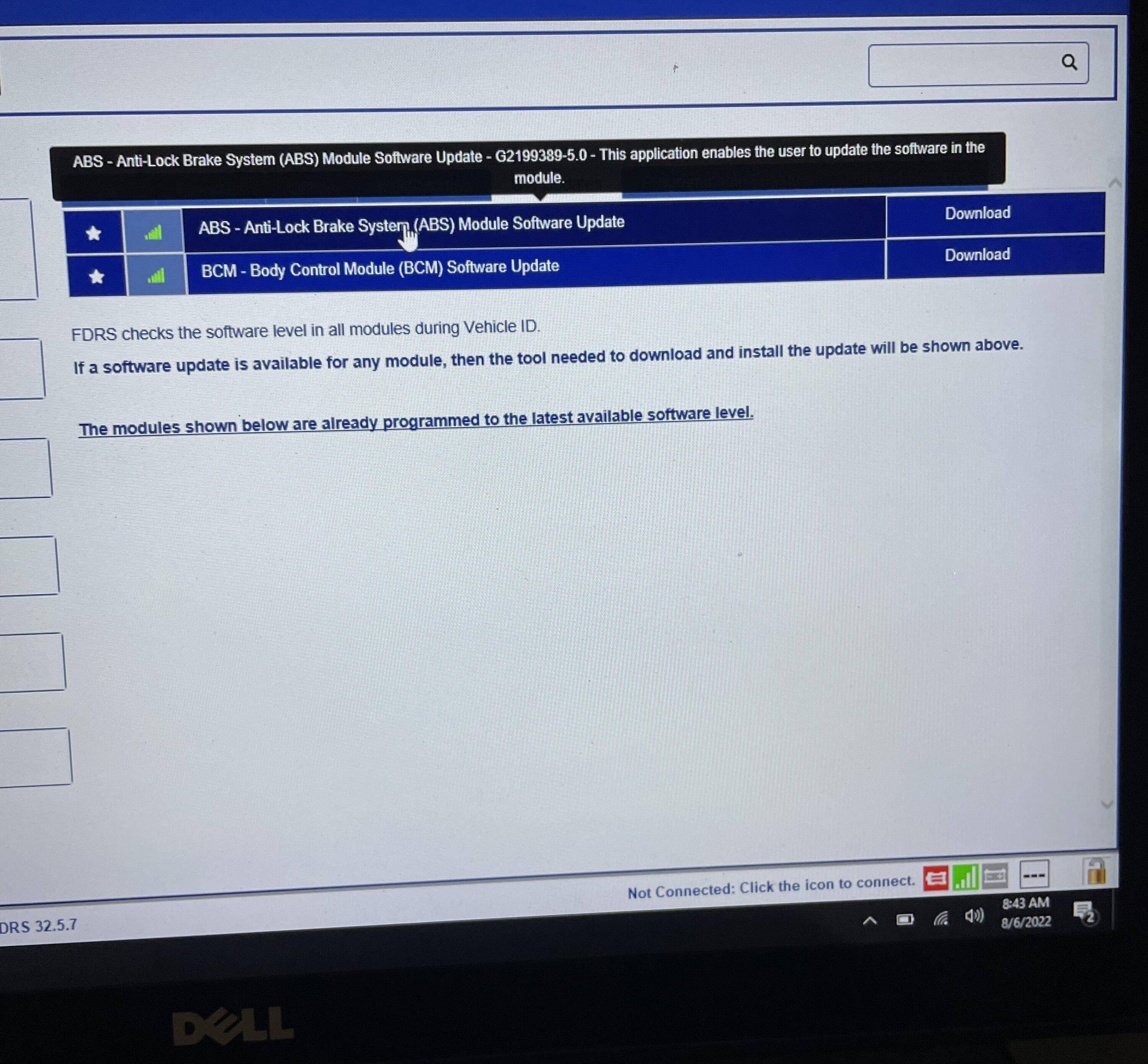

A couple new updates for 2021 F150 5.0l 302a with 8” cluster came out this morning. ABS & BCM
Ford F-150 ECU module programming guide using FDRS 1659803545778
Ford F-150 ECU module programming guide using FDRS 1659803574530

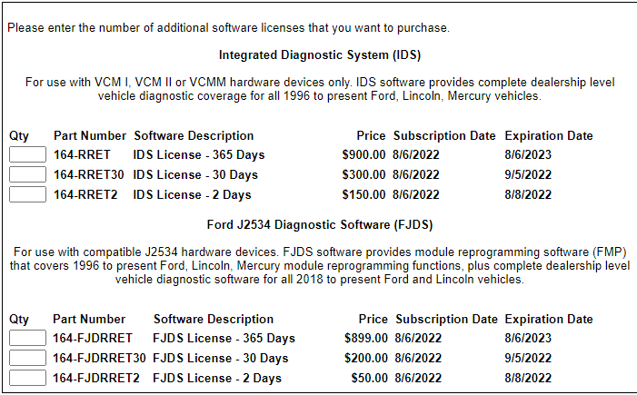

Has anyone had trouble activating your FDRS license? I've downloaded all of the software and purchased a license but when I try and activate it it fails. I've double checked all network & firewall settings but it won't work.
When I purchased the 2 Day license there wasn't a FDRS version, just the FJDS version but my understanding was that the license is the same. I followed the links in this thread and directly from the Mastercraft site but this is all I see:
Ford F-150 ECU module programming guide using FDRS 1659818886653
I'm assuming its operator error (isn't it always?) but if anyone has any tips it would be greatly appreciated.
Did you set up accounts on both websites—the one where you bought the software and motorcraftservice.com? You can use the same credentials for both accounts for convenience, but you need to set up an account here http://www2.helminc.com/ngsm/login....4119969BB71E08853AE2&from=ford&src=motorcraft AND here https://www.motorcraftservice.com/. You use the credentials you set up on motorcraftservice.com to log into FDRS.
I haven’t created the second account yet as I haven’t been able to get that far in FDRS. I get the add a license pop-up but am unable to get it to verify my license. My only options are to check network settings and quit.
**Edit: It turns out I did have a Motorcraft Service ID but still no difference in adding the license to FDRS
Are you logging in as Non-dealer Motorcraft? Use the drop down to select the kind of user you are.
Until I add the license I'm not able to interact with the program at all. It just keeps giving me the 'unable to verify license' message. I've been cutting/pasting it as well as double checking to make sure there aren't any typos but no bueno.
