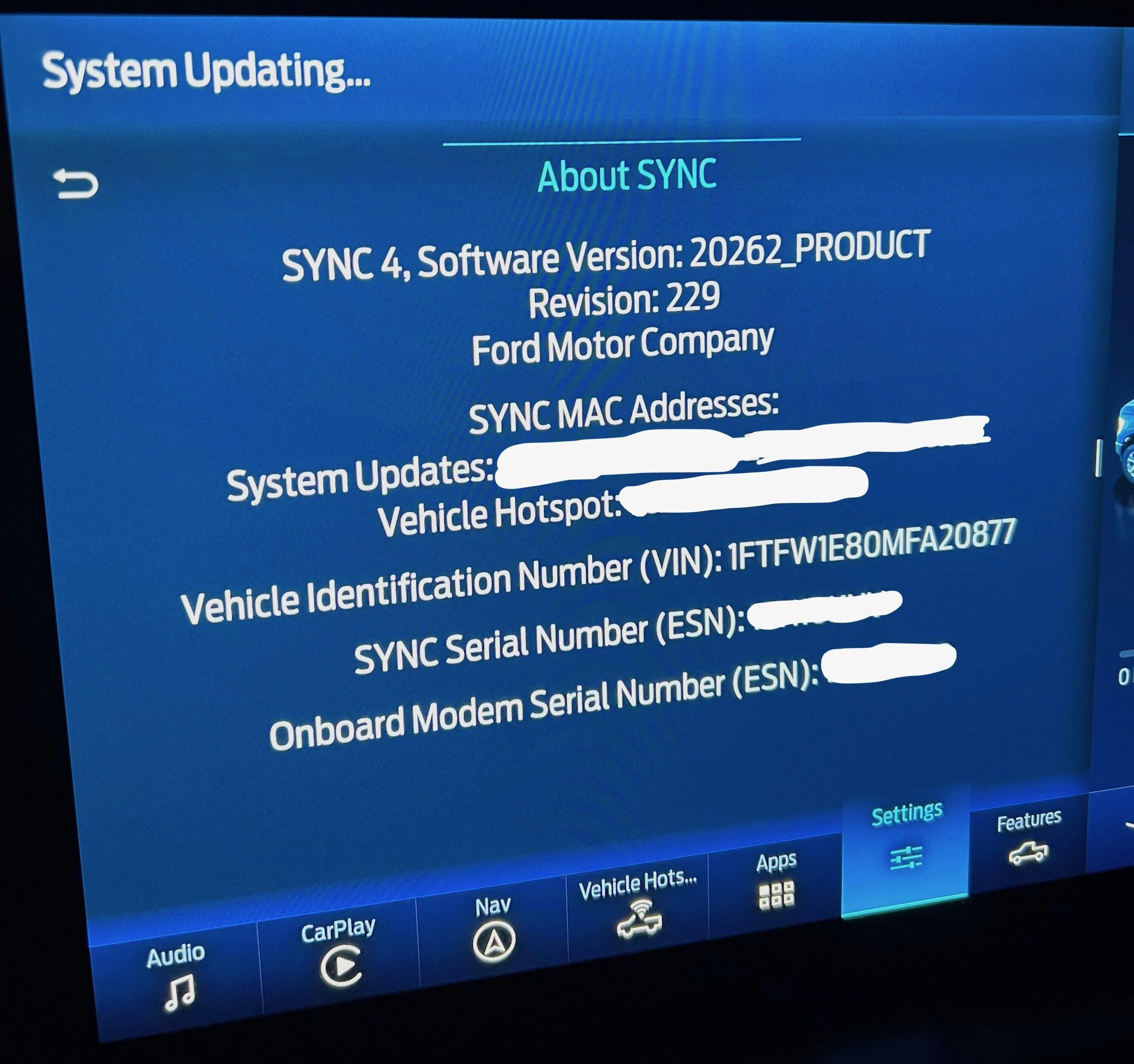

After going through the aforementioned APIM update processes and procedures (and leaving the USB thumb drive in the console), the upgrade appeared to "kick-off" yesterday evening (after two days). Once the screen asked for the system restart, I shut down the truck, got out, locked the doors and went inside the house (while leaving the USB thumb drive undisturbed in the console). I returned 15-minutes later to restart the truck. To my total disappointment, nothing appeared to have changed; no SYNC version data, automatic update sliders greyed out, and no indication that the update was complete. I drove around for about 45 minutes in the event that things were still processing, but no joy.
Below is the "system updating" screen that I was watching prior to my complete heartbreak. Has this happened to anyone else?
It looks like FDRS gave you the same version you already had. I can get you the correct files if you want me to. The files I give have worked for everyone that I have provided them to that I am aware of. I havent had anyone tell me otherwise. I looked and I dont have anything showing I gave them to you I had never pulled your vin.

Would I not have still received an "Update Successful/Complete" message after restarting if that was the case?
That would be awesome, @Jesse-Infotainment! Thank you!
Not always. Sometimes the update successful message isnt displayed. I would have expected in your situation that a update already installed message. To me I am betting thats what came up and maybe missed it. Since everything stayed the same.
Can you take a screen grab of the contents of the USB drive? Root and update folder so I can see the contents of the drive.

Certainly. Thanks, again!
Those are the correct files.
Well not sure what happened to be honest. Es is 21146 so it should have updated you.
Try the files I sent. It’s fresh see what happens. I’m not as confident now seeing the content of the usb drive.
