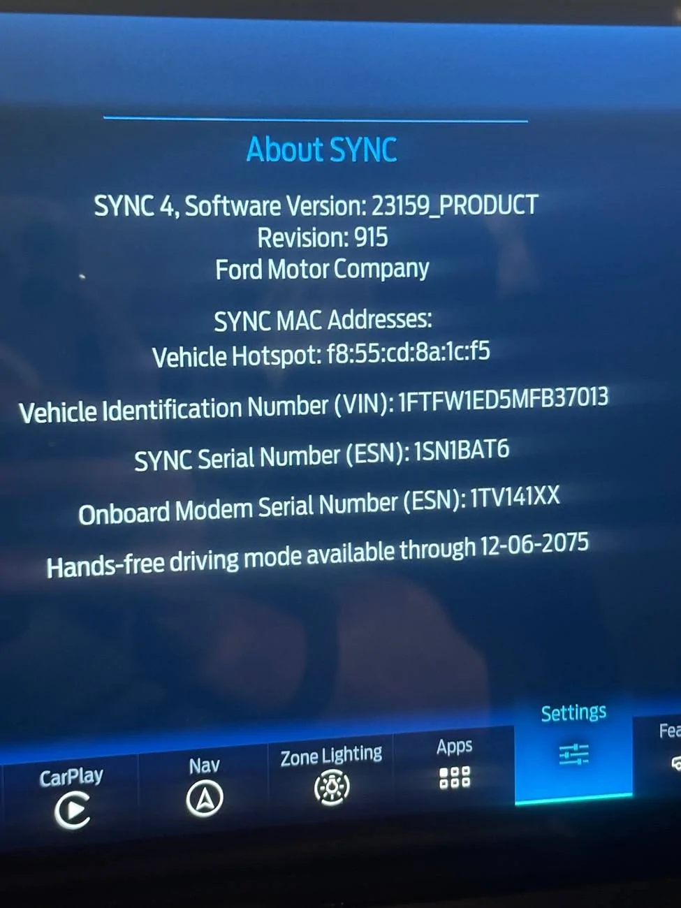

I am on a much newer version and revision now and blue cruise prep update did succeed and I have hands free driving enabled in features and sync info, however lane centering assist is still not available so blue cruise still doesn't technically work.
Spent 5ish hours today doing various GWM, TCU, and some APIM updates that were 5gb however it must need more updating to catch up with wherever the IPC/IPMA is since I have not seen any new updates for those while going through APIM/GWM versions.
So far the new features I have now are video in motion for the bed camera, and full screen carplay, both of which are big features I was looking for. But since lane centering assist still doesn't work, I don't get bluecruise or even normal functionality of lane centering

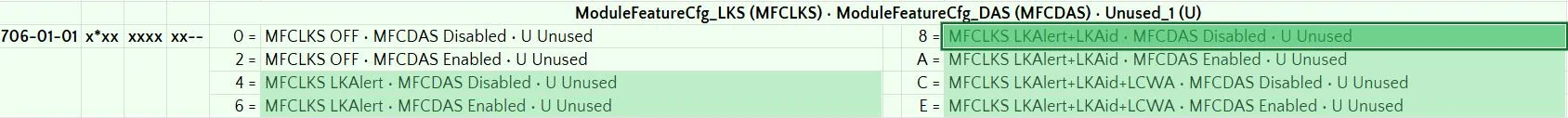

@booostin I think I found it. Do you have FORScan? Make this change:
706-01-01
xExx xxxx xx--
Your truck shows an A there now. An A there means LCWA is not enabled. I believe LCWA is lane centering with assist.

Interesting. The lane centering worked fine when I first got the truck. It was updating the IPMA originally that caused the disconnect and it hasn't worked in the last 3ish weeks while waiting for the first APIM update to kick off. The only FORscan thing we changed was disabling the double honk when exiting the truck running with the keys. Should I keep proceeding with updates before changing that in FORscan?
No, I would address the lane centering asap. If it worked before, it should work now and after the updates are complete. Maybe the IPMA update you did messed up the config somehow, or the BC prep kit thing did. Not sure, but my truck has an E there. I compared the ab data on your truck to mine in the IPMA, PSCM and SCCM and that's the only thing I see that didn't line up.

@booostin I did some more digging and it seems like an A there is correct. Not sure why my truck is showing an E when I pull the a/b data from Ford. I will plug into my truck tonight when I am home from work to verify I do have an A there. I'm stumped as to why your lane centering does not work.
