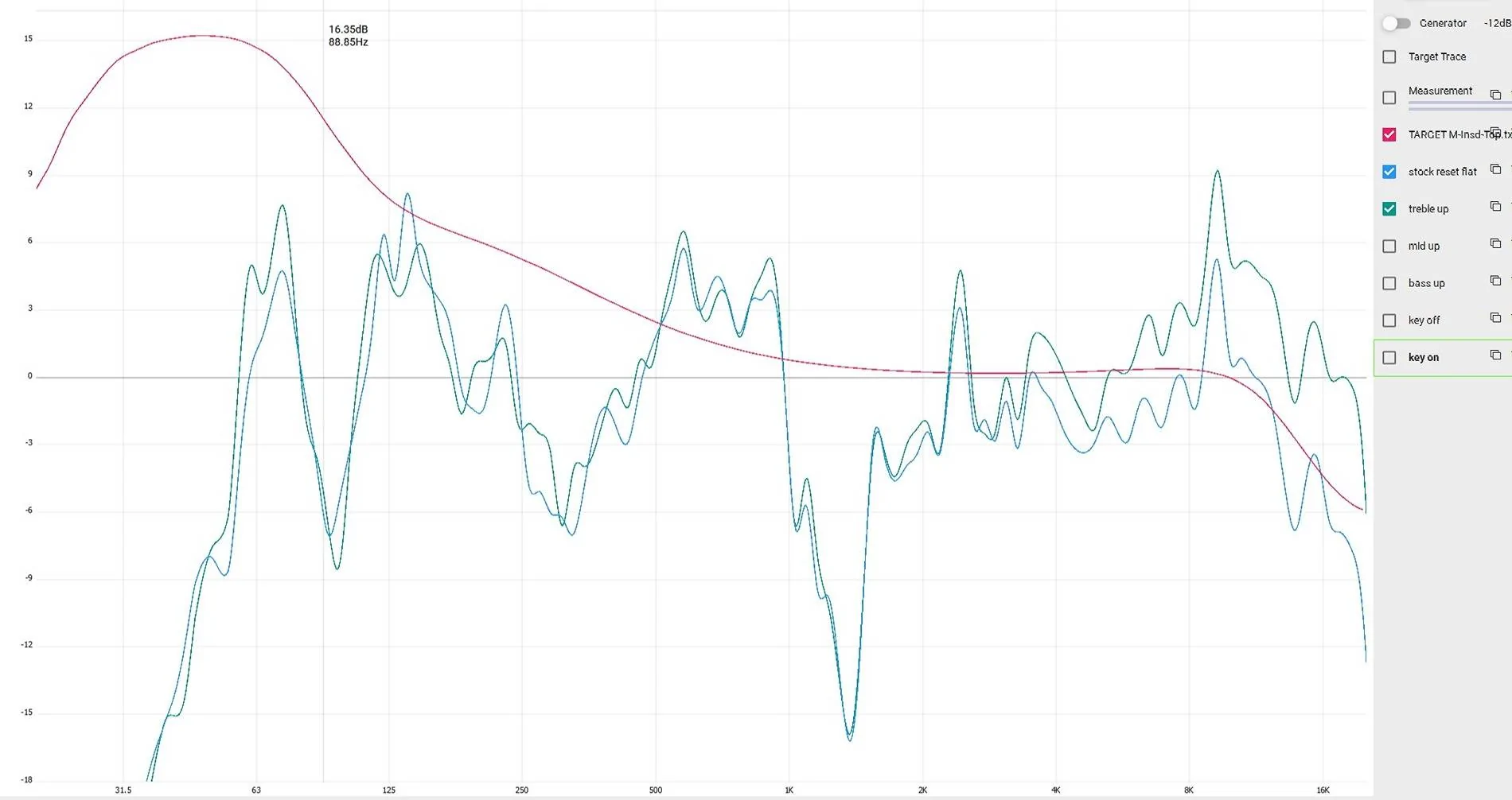

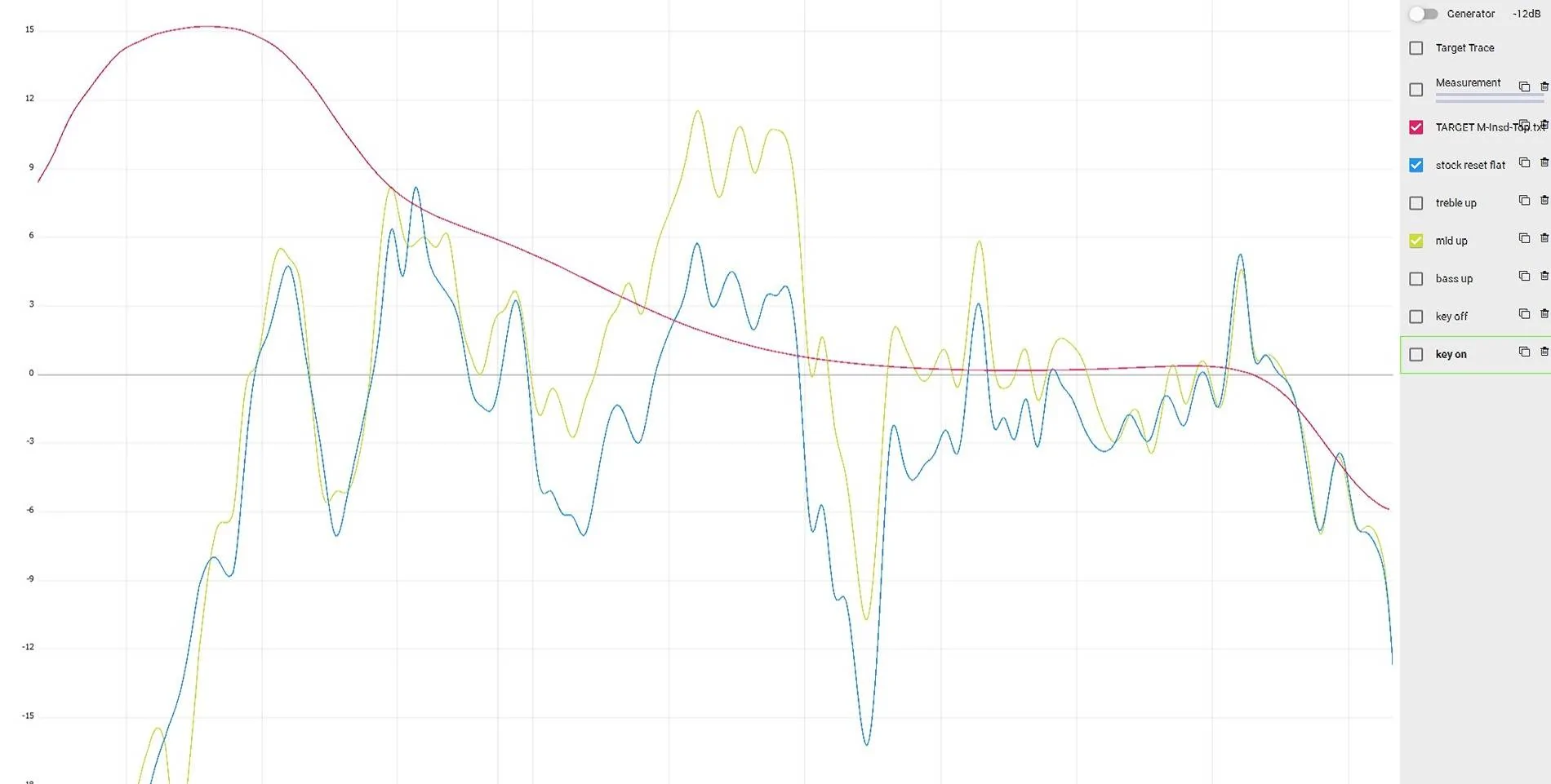

Just for the sake of sharing the other stuff I looked at while trying to figure this stuff out.
The treble settings look to be adjusting 3k+
The mid controls 250 to 3k
Bass 250 and lower.
I did look at a few other screens but I think most people will quickly understand magnitude. Coherence is also pretty nice to see how close you are but kind of a deeper level of paying attention there.
That huge trough around 1400kHz is pretty concerning. That'll suck the clarity out of most anything.
