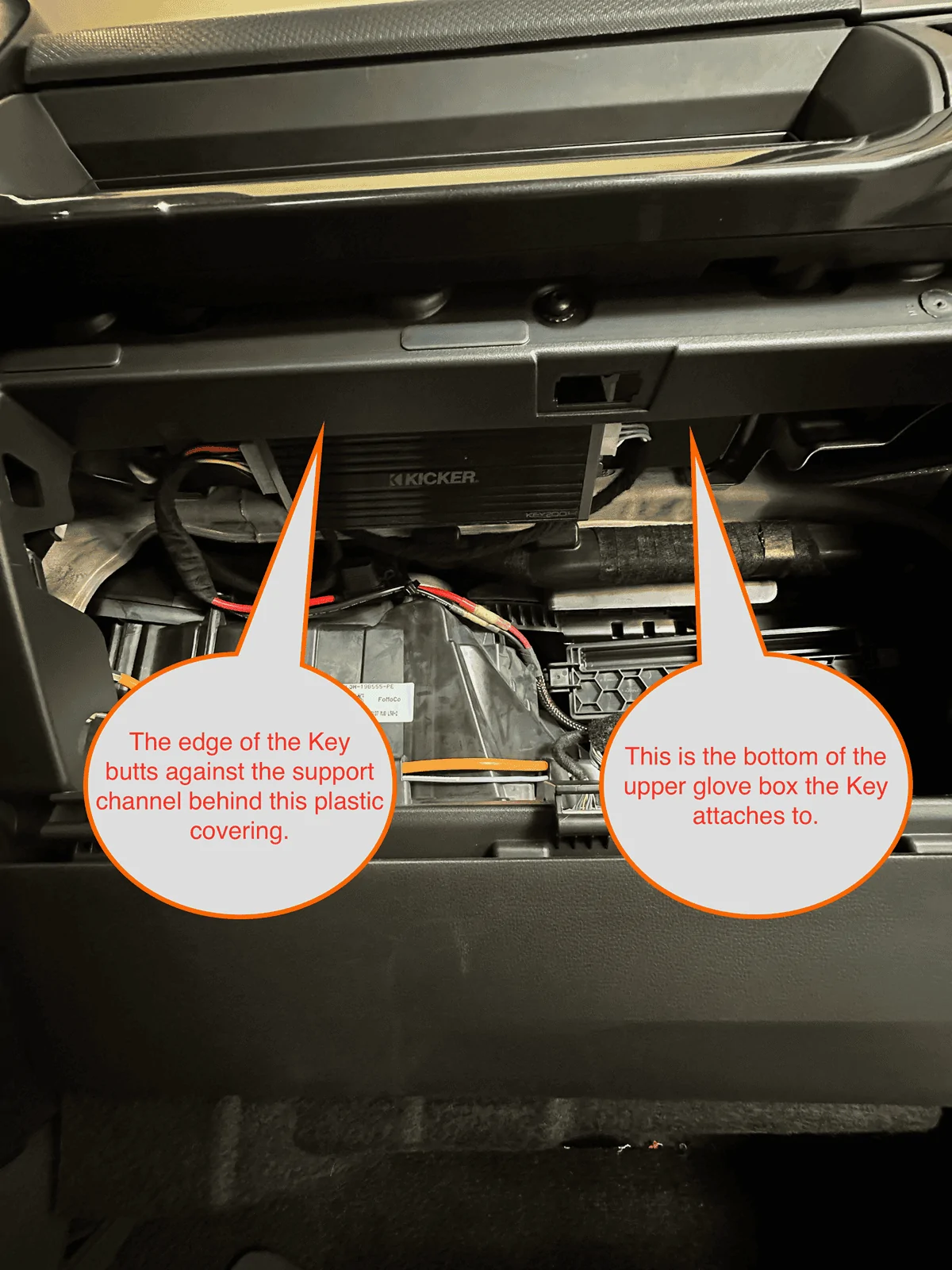

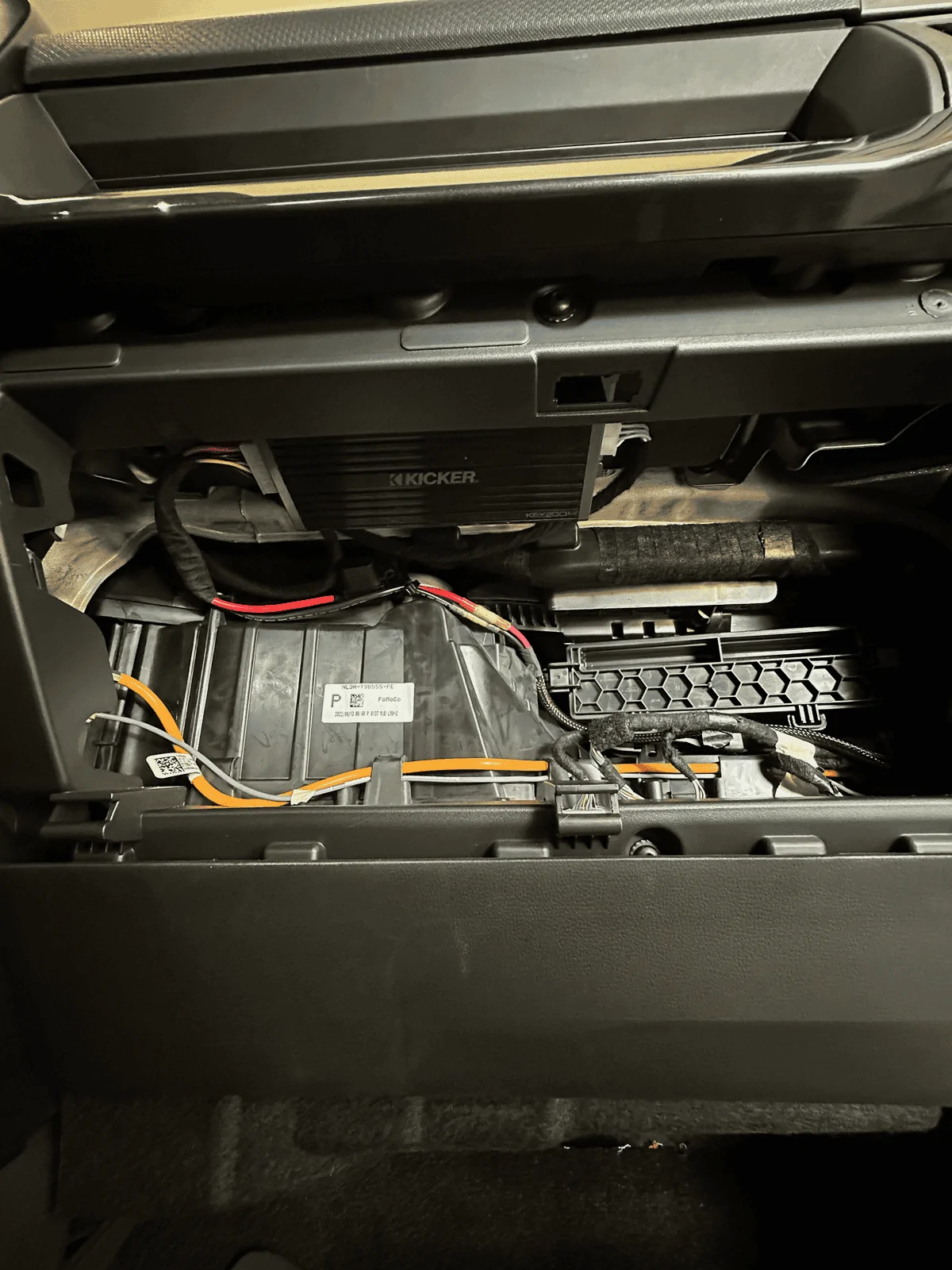

I mounted my Key 200.4 up and behind the lower glove box. I also used the plug-n-play harness. I wanted access to the switches and dials on the key. You have to trim a little (1/4") off the back of the glove box to clear the key when you close it, but no big deal.....
What did you use to fasten the key? I tried doing the same using 3M VHB tape but it wouldn't hold.
I used these velcro strips....
https://www.amazon.com/gp/product/B09BNPX3XJ/ref=ppx_yo_dt_b_search_asin_title?ie=UTF8&th=1
I cleaned both locations with 70% alcohol, let it dry, with both pieces of velcro stuck to each other, I removed the sticky side film from one side, stuck it to the Key, removed the other sticky side film, carefully (you get one chance ;)) angle the Key so you can insert it against the support the lower glove box latches on.
Could I bother you to take a pic of how you trimmed the glove box. Also what did you use to cut it?

I installed the key above the glovebox and trimmed a little bit off just like @TexasTruck so it will close properly (not hard at all)

I ran the stock tweeters for a while until I received the tweeter brackets from @SoundsGoodStereo for the Kicker component tweeters. Glad the Key mounted up for you. I forgot to send a pick of my glove box for ya….
