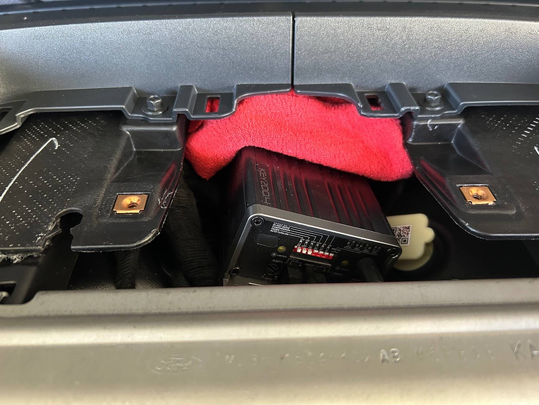

OK, I did a similar installation. I just finished it today. I typed it all up, but then I lost it so now I’m dictating this please excuse any problems. I used kicker key 200.4 amp mounted at the top of the dash behind the radio just under the access panels so it’s easily accessible. I used kicker KSS 670 door speakers and tweeters. I use the kicker 51 HS 10 sub under the passenger seat. I use a custom wiring harness from Bruce Watson at hush car Audio when I was installing the door speakers, I went ahead and added sound dead material And block off plates from sound good stereo. I also used 42 mm Twitter mounts from sound good stereo. ran 10 gauge wire and three 12 gauge wires from the battery through the passenger side Gromit into the cab. The ground wire goes to a distribution block so both amp and sub are connected to that distribution block the amp and the sub have their own dedicated 12 gauge powerline to the battery each powerline has its own 15 amp fuse put everything together today and ran the auto tune set up from the amplifier. it for sure sounds much better than it did before I ran that auto tune , additionally on my 2024 I use the auto start wires connected to fuse number 30. That’s the only fuse I could find that is switched fuse. People use fuse 23 for earlier models On my truck, fuse 23 is constantly hot on my truck Which is a 2024.
Some photos attached.
Also I am having a custom panel 3D printed for that hole where the cord hanger used to go. I will mount my bass control knob on it.
