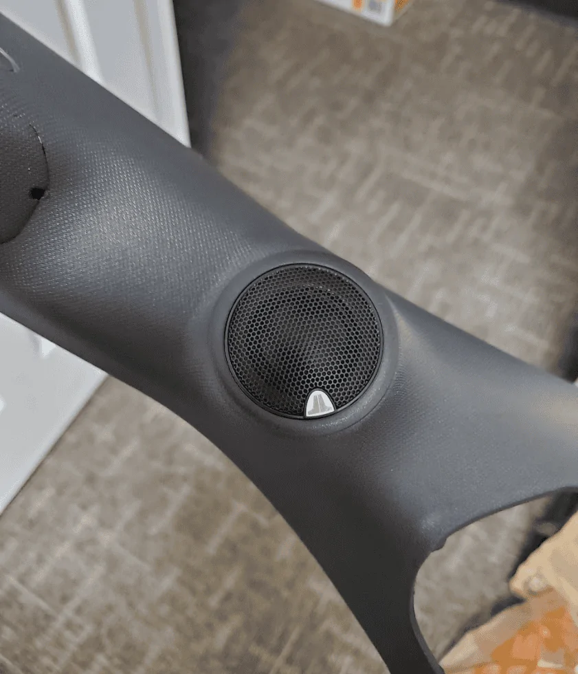

I put 1" JL C3s in mine. Looks better than factory too. It's really just having the tweeter right up in the stage that makes a difference. $199/pair and includes tweeter protectors.
Ford F-150 Kicker Key install setup questions 1712274187850-a0
Ford F-150 Kicker Key install setup questions 1712274225038-12
I have alpine type x 6x9 woofers in the door which are a unique set of woofers able to take full range. JL tweeters are a bit bright but the DSP makes correcting that easy, I roll off 6db around 4khz all the way up. The combination outperforms every sub $1k 3 way sets I've heard without having to find a spot for a 4" mid. The tweeters are only wearing their protection devices while the 6x9s get full signal rolling off around 45hz (same channel). Might seem like an odd pairing but the $300 I saved creating this setup went into the DSP.
