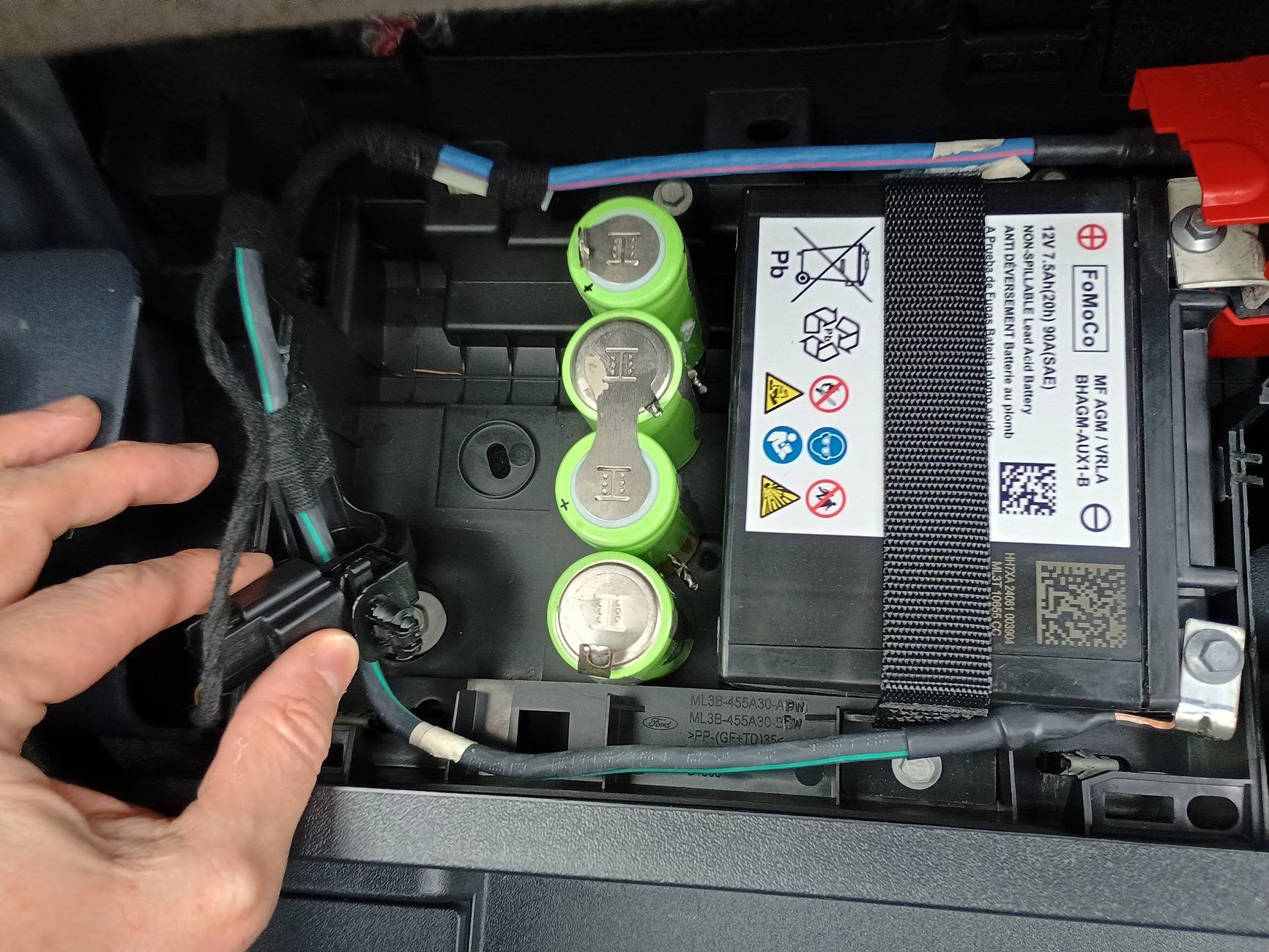

Sorry to sidetrack. Considering a custom build in parallel using 32700 cells in the Aux battery box. The catch, is that the current sensor on the negative wire is awkwardly jammed in that space. As you can see, lots of space underutilized.
In the trucks with two AGM, where does the sensor fit? I would love to make enough room to parallel cells to make a 12Ah pack. In parallel, there is only a few mm difference between vertical/horizontal. So just hoping that there is a tried & true relocation option.

Do you have a BMS to protect those cells? The truck can put out up to 15.2v, those shouldn't exceed 14.6v max or 3.65v per parallel cell group.
My current transformer is wedged into the side
BMS - yes. It is about 9mm thickness, so I need to account for that. It might be underrated - bought the Daly 15A 4s before I was certain about my configuration. We'll see. Tough to find a small BMS with temperature protection.
Thanks for the image of the sensor squeeze. That helps me visualize possibilities.
