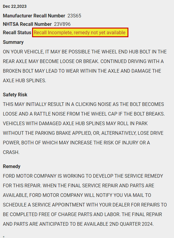

HANCOCK
Bob
Apr 4, 2023
119
88
South New Jersey
2022 F150 powerboost
got recall no fix Till second quarter nice just Till they can figure out the cheapest way to fix it I guess that's what that means
Recalls *
Rear axle half-shaft and hub assembly replacementRecall Incomplete, remedy not yet available
Campaign/NHTSA#
23S65/23V896
Issue Date
2023-12-22
Description
On your vehicle, it may be possible the wheel end hub bolt in the rear axle may become loose or break. Continued driving with a broken bolt may lead to wear within the axle and damage the axle hub splines.
Safety Risk
This may initially result in a clicking noise as the bolt becomes loose and a rattle noise from the wheel cap if the bolt breaks. Vehicles with damaged axle hub splines may roll in park without the parking brake applied, or, alternatively, lose drive power, both of which may increase the risk of injury or a crash.
Remedy
Ford Motor Company is working to develop the service remedy for this repair. When the final service repair and parts are available, Ford Motor Company will notify you via mail to schedule a service appointment with your dealer for repairs to be completed free of charge parts and labor. The final repair and parts are anticipated to be available 2ND quarter 2024.
Next Steps
Contact your local dealer and schedule a maintenance appointment. To find your local dealer, use the "find a dealer" feature below.

I've not yet received a snail-mail or FordPass notification, but I do now see the axle bolt recall listed when I enter my VIN in the NHTSA and Ford Owner recall lookup websites.
Nope, no permanent remedy yet, but at least there should be no question about getting the 'temporary' fix now regardless of warranty status (my VIN / date-range was not 'covered' in the pre-recall CSP).
Knocking on wood, no problems with my bolts to this date.

Hmmm I just entered my VIN and Im also part of this recall. Originally I was out of the designated range of the recall... now it looks like Im in.....
Are you sure that wasn't the Ford CSP (distinct from the NHTSA recall)?
The NHTSA recall is just now posted on those lookups for the first time, thankfully much more comprehensive than the CSP.
