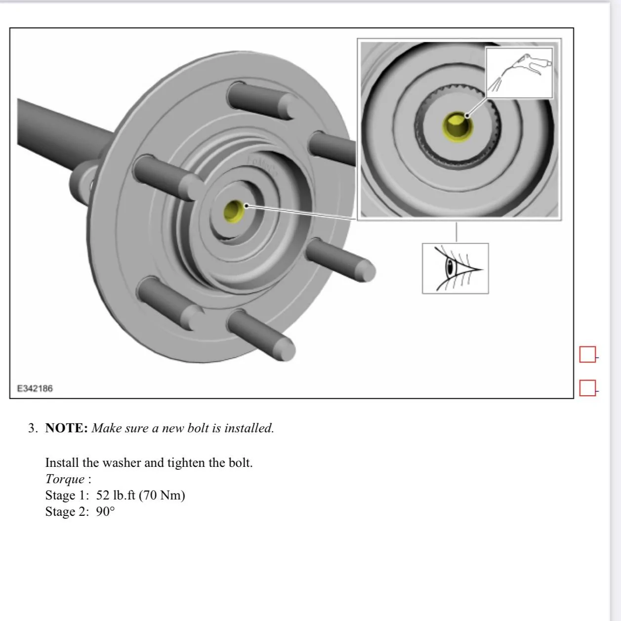

@Snakebitten I torqued them to 90 ft lbs which is pretty damn tight, and way tighter than the factory ones were in there. My intent was to prevent any movement and therefore wear on the splines. Time will tell if that was the right thing to do.....
I did 84ftlbs I think. But that's far less than what the torque procedure calls for.
HammaMan, I don't know if they are one-time use or not, but if you tighten them as much as the spec calls for? I wouldn't use them twice. 12mm is NOT that big of a bolt and it feels creepy to tighten them that hard.
Since I'm willing to check, and even replace the bolt every tire rotation, I feel very comfortable torquing less.
That 90° feels queasy.
It's like changing spark plugs. I have a sense, a feeling, of about as far as I'm willing to go. If the spec is much beyond that point? I ain't going to use the spec.
Honestly, I never knew someday I'd have experience with the kind of bolt that is used on this axle. Buy a vehicle, drive a vehicle, trade a vehicle and never have a clue about the torque spec or bolt locating the splined axle. ???

One the other hand, Do you really want to replace the bolt with one that doesn't break? As it stands, The factory bolt breaks when the pressed in splines have become damaged. Replacing that bolt kind of eliminates that tell tail of a bad shaft.
Unless of course you do as SnakeBitten does and routinely replace and inspect the bolt and the shaft.
