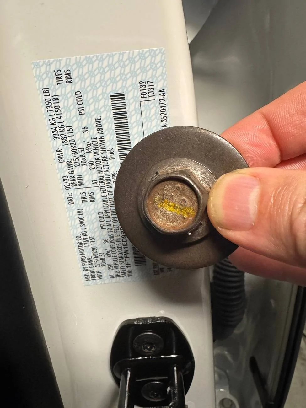

Hey all, I have a 2023 Powerboost with a broken axle bolt. My VIN is not covered by the recall, my build date was 2/6/23.
I would very much like for Ford to expand their recall coverage as I don't want a like-for-like replacement with another defective axle. I called their recall support line and opened a case, however they were emphatically unhelpful. They told me to file a complaint with the NHTSA, and they'd only expand the recall if they were forced to by the regulator.
I have since filed a complaint with NHTSA, and I noticed by looking in their database that a handful of other '23 owners are in the same boat: broken bolt and no recall coverage. If anyone out there has a '23 built after December 2022 and has a broken bolt, PLEASE file a complaint with NHTSA. Ford is hoping they get away leaving us high and dry.
I got a call from a NHTSA investigator less than 12 hours after filing my complaint. I am hoping they will find a way to motivate Ford to fix *all* of their defective axles.

You really aren't out of anything currently though. If any truck shears a bolt at this point, they are getting the same warranty repair regardless of recall.
(y) At least through the duration of the 5-yr / 60,000-mile powertrain warranty.

Redesigned parts are supposed to be hitting the streets 1Q25, what happens when i break my next bolt in late 2025? I get another serving of the garbage axles and earlier builds are getting the good ones?
Yep.
And even if you don't have ESP and you are far beyond warranty, the whole assembly is something like $370?
I ain't happy about any potential weak points in my truck. But I'm hoping the potential sheared bolt is the worst problem I will ever face.
I'm more concerned about that CDF drum rearing its head after my warranty has expired.
You think Ford will have 2 different assemblies?
And you are sure that Ford's recall remedy is trouble-free?
