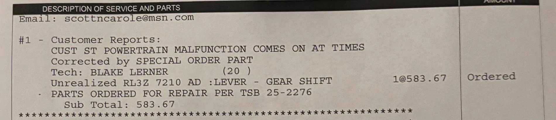

My 2024 XLT 5.0 just popped the Powertrain malfunction alert with wrench (8800 +/- miles) twice over the last week or so. First one clear on its own and second one hung fired for about 2 hours. I called the dealer who loggers into my vehicle via connect service portal and confirmed the alerts and pulled up the service bulletin. Dropped truck off for indeterminate stay. Given Ford (a) knows about this problem and (b) has my vehicle’s in his “connected service” portfolio and can see the alerts why weren’t they proactive and call me???
I just got this error, and my 2024 has 200 miles on it, took to dealer they said bad battery so they replaced with a new one. The very next day happened again, and now my shifter won’t lay down
yikes…just got mine into the dealer Monday for the infamous “Powertrain malfunction/reduce power …get service soon” alert. They had it for two days and confirmed it’s the shit module according to Ford Service Bulletin and soon to be issued recall notice. Of course the part is on b/o with no ETA available. The service consultant called me and said come pick it up as it no problem to drive it with the malfunction alert. However, based what others stated it concerns me that Ford isn’t completely transparent about potential unintended consequences of a “software” program bug or wiring problems. I located a copy of the Service Bulletin and it indicated that there is a potential plug-pin losing connection due to a manufacturing defect in either the plug or the shift module receptacle. Case in point our Lincoln Nautilus Black Label received an over the air (WiFi) software update that resulted in a recall as the software up date caused a safety issue with the back up and other cameras in the collision avoidance system. Again, YIKES!!!… YGTBKM…I hope their General Counsel is paying attention and advising Ford’s leadership about what happened to Boeing over bad software on their 737 Max!!! The 21st century vehicle is now so full of software code it’s impossible to avoid going to the dealer for service.
