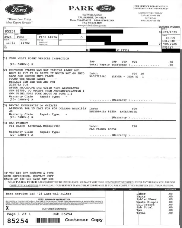

This is a follow up to an earlier post I made on this thread about the gsm in my truck failing. Without repeating the entire previous post, I believe that because my truck had stranded me and I utilized Ford's road side service through the Ford Pass app, I was assigned a caseworker so to speak. She called me often to keep me apprised of things. I received a call from the caseworker the morning my truck was finished being repaired. I was asked to share my thoughts positive and negative. Positive - very appreciative of the communication from her and the dealership. Negative - 2 weeks without my truck cost me a lot time and money. The caseworker offered to pick up 1 month of my truck payment and did. Ford transferred the money to the dealership and the dealership cut me a check. Attached is a copy of the workorder and check. In all, I am very appreciative of how everything went for me and I hope others have the same or better experience.
Ford F-150 Powertrain malfunction 2024 f150 Screenshot 2025-08-12 093641
Ford F-150 Powertrain malfunction 2024 f150 Screenshot 2025-08-12 093740

Glad they made it good for you. I was fortunate that my truck was still driveable when my shifter started acting up. Took it to the dealer, they ordered a new GSM, called me when it was in and took 2 hrs to replace it and the battery. But it sounds like you had a good experience all around.
