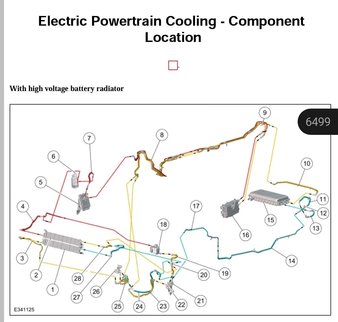

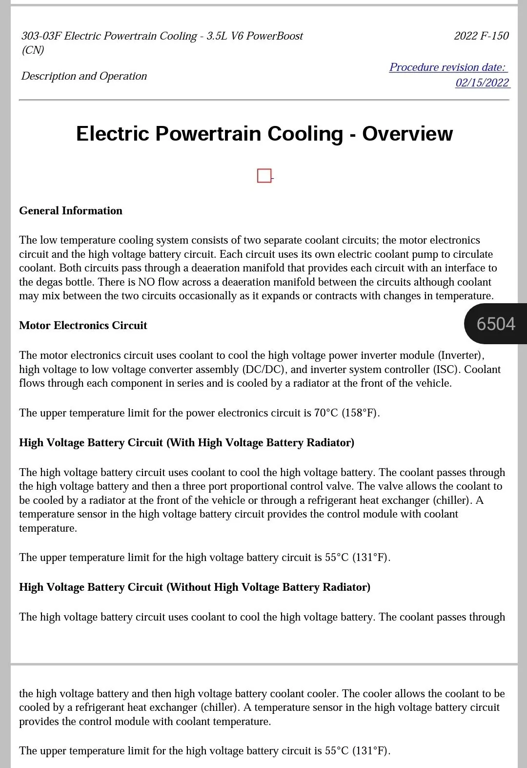

Just For Informational purposes, I have included the Hybrid/electronic coolant loop.
Note that it's high temperature limit is 131F
That's why it makes sense to me that it doesn't need any help from the ICE coolant loop or the exhaust heat exchanger. 131F is considered HOT in the Hybrid coolant loop. In the ICE coolant loop 131F isn't considered even warm up yet.
Very interesting they can both heat and cool the battery as required. I'm hopeful this speak to longevity of the HV battery over the years

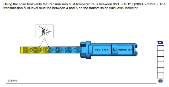

Tells me the aux pump is probably starving for fluid. Maybe try putting some 2X4's under the lower end wheels to bring it to level and then see what it does.
I have the PDF of the fluid check procedure on my computer at home. It's fairly easy but does require the transmission to be at operating temp. Oh and the dipstick plug is an ABSOLUTE PIA to break loose.
I'll post it up later this evening.

Forgot I had it on my work computer as well.
If I remember correctly, there are two versions of the dipstick plug one with numbers and one with letters.

I'm fairly sure it will be the same just depends on if ours uses the number stick or letter stick. I think the letter version was when Ford first released this transmission but then updated it in 2019 or 2020 with the numbered stick..
Some have A,B,C. Some have A, B only. Still other 10R80's have numbers.

Not sure if they changed it but here's the three dipstick versions as he describes in the video. They are all from 2020. What's messed up is my 20 Ranger had the numbered stick but others produced around the same time had the lettered version sticks. Wish Ford would get it straight.
