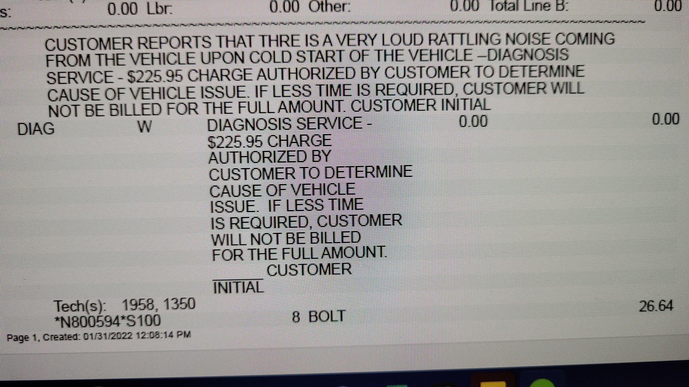

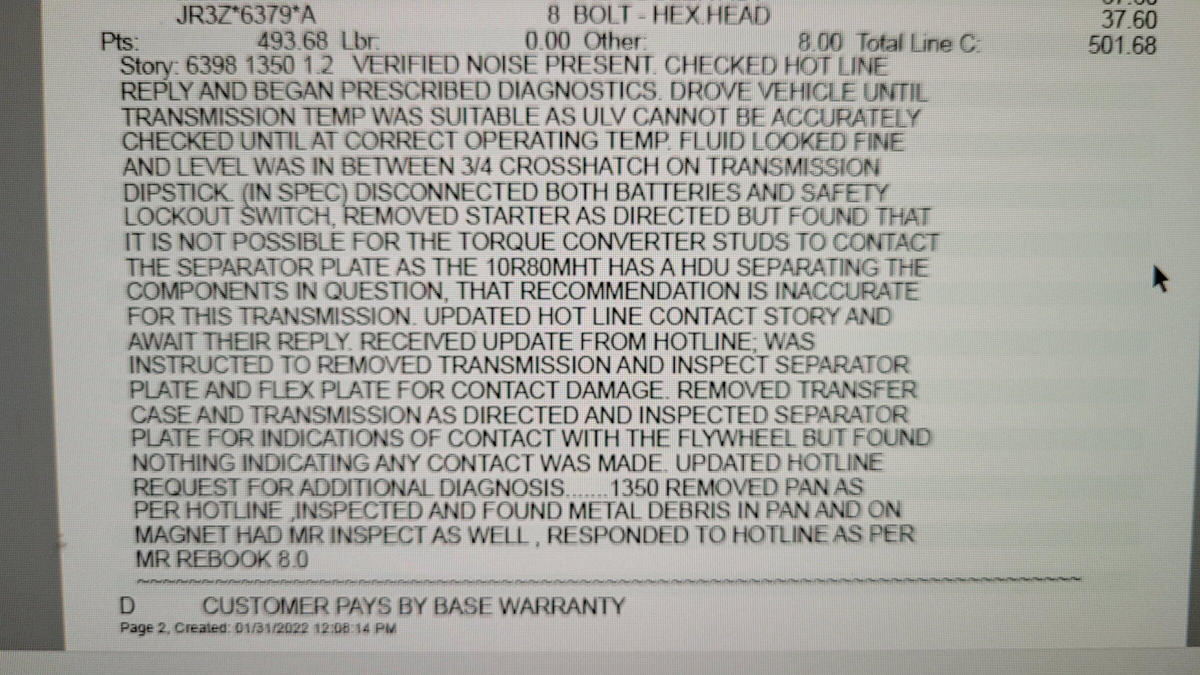

I have had the same issue with my Truck since November. My truck has been with the dealer since middle of December. The dealership was following the recommendation from the Ford techs finally on Friday the removed the transmission pan and found metal filings and chunks on the filter and the pan.

If possible could you post a screenshot or picture of the work order/receipt so I can show my dealer? They claim that nothing is wrong.
