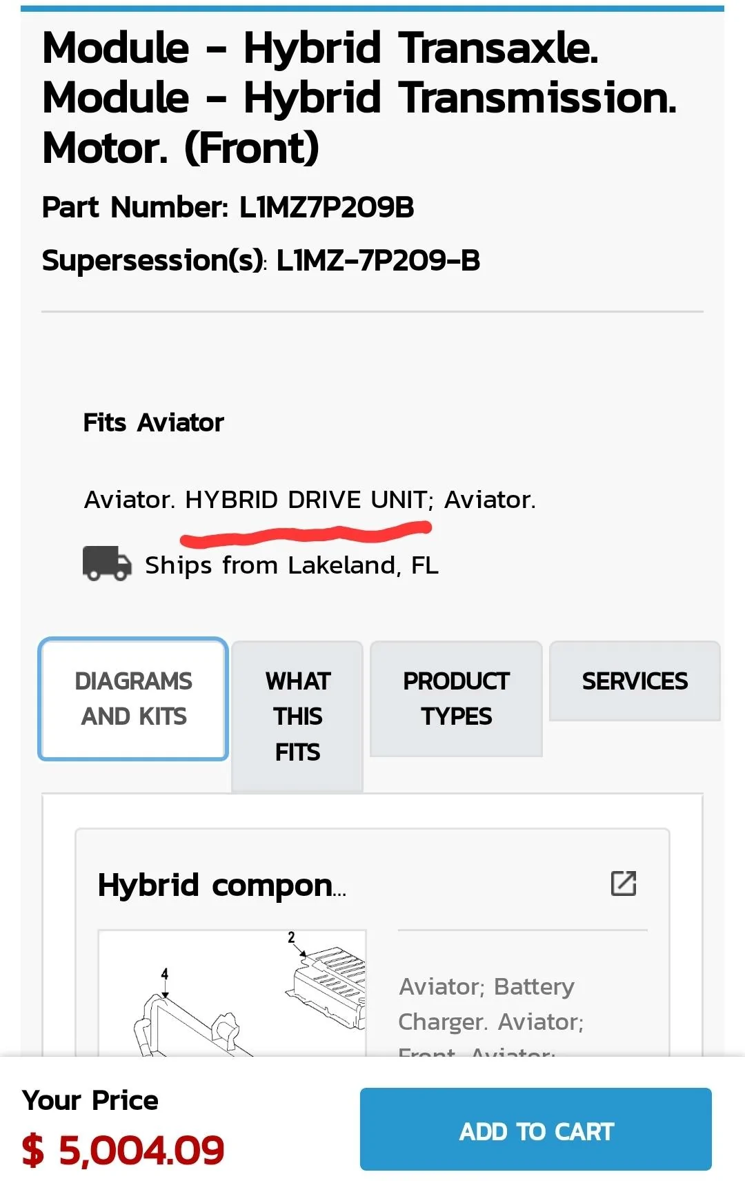

I was thrown by the description "Hybrid Transaxle"
It's because Transaxle immediately conjures up images in my mind that just didn't apply to the Powerboost Hybrid Drive, and where it is located.
It's basically the unique electric motor/torque converter in the 10r80 MHT transmission. At least unique to the Powerboost that we all drive.
Then I looked up the referenced part # and it made more sense. It IS in fact what is referred to as the Hybrid Drive Unit.
Oddly that part number is listed as the one for the Aviator.
We only DREAM that we had the same Hybrid Drive that the Aviator has!
Ford F-150 Powerboost Cavitating Noise on Cold Start Screenshot_20230328_111645_Brav
